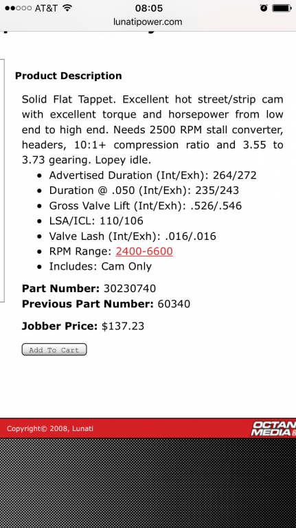

solid or hydraulic cams 383 eng or 440 need opinions for my 383 eng.i am looking at the 526/546 lift,235/243,110 lsa solid. friend has one in his 360 motor in a duster,he loves it,nice lope,good pick up low to high rpm. thanks
