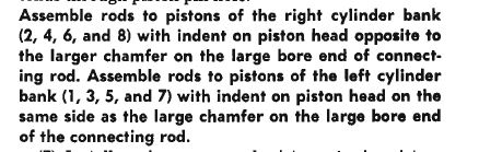

Commonly the rods and pistons went one way and the larger chamfer was on one side of the big end. This is from my 69 manual.
They are chamfered on both sides, but one chamfer is larger. Also, the bearing will ride towards the small chamfer side. If you just assemble the pistons to rods with the locks out and 1/3/5/7 on the driver (left) side and 2/4/6/8 on the pass (right) side, everything will be fine...
