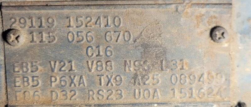

So I went and looked at a possible new project car today and got stuck trying to decode the fender tag. Any help would be nice to have
Looks to be an eb5 blue over blue, strip delete air grabber 1970 GTX 440

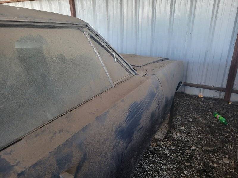

It's pretty rough, I didn't take any good detailed pictures. Once he told me the price I got disinterested pretty quick.
It's a 4 speed car and has a dana 60 laying under it that he claims belongs to the car. So I was trying to figure out if it's a super track pack car.
It was an automatic originally
with air grabber
Hood performance paint
deleted side stripes
Hood turn signals
Console and buckets black interior
Tag looks to indicate a console automatic if I remember correctly
This is why I post these questions, owner says he has owned this car since 1976. Been sitting in the same spot since 84 when he decided to tub it and narrow the rear frame rails. Never finished it, trunk pan is gone fender wells are gone as well as some of the support behind back seat.
