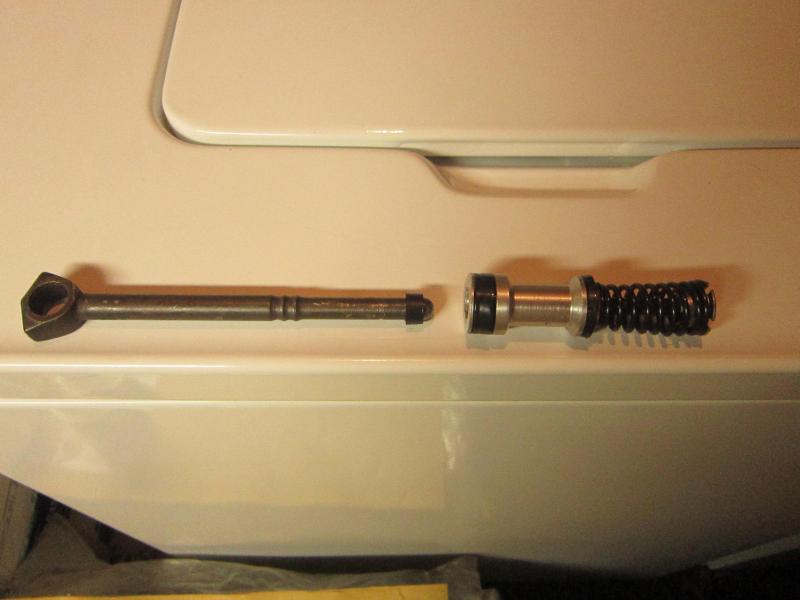

getting a new master cylinder for the Roadrunner today, but before going any farther, i need to get the brake push rod out of the m/c valve assembly. how is it held in there? how can it be removed?
thank you,
It's should just come straight out. It's just stuck after years together.
Yeah. Should be a ball-shaped end on the rod. If I remember right, that end is forced into a rubber sleeve, that's fit into that end of the piston. It's simply there for positive movement. A little tough, but should pull apart.

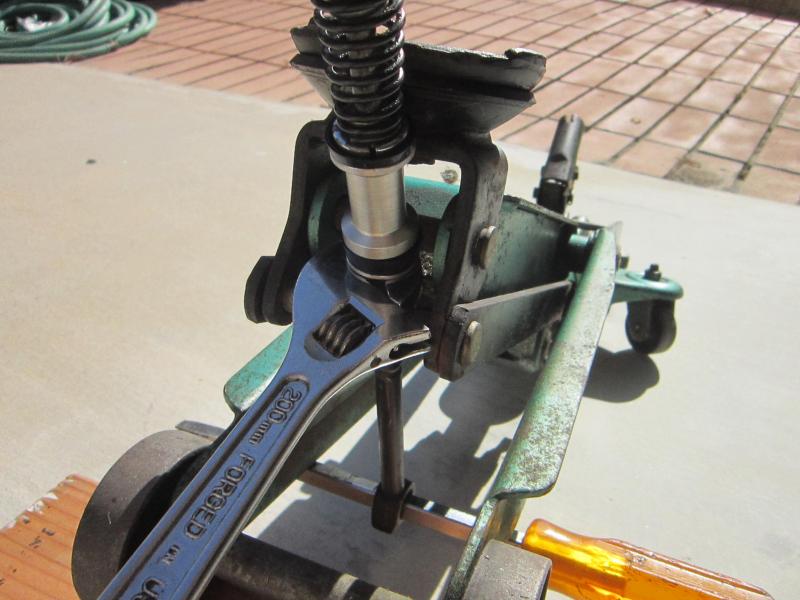

well, with the help of my floor jack and putting a large screwdriver through the eye of the brake rod, a couple of pumps on the jack and it came off. this would be extremely difficult to do by hand.173.jpg
here's a pic of the setup for anyone else looking to pull the rod out alone.321.jpg

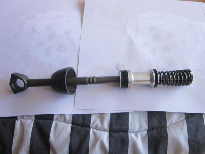

all I use is an ice pick to slit the rubber grommet. then pull it apart. but your way is easier.
That rubber grommet is unbelievably difficult to remove but glad you had a clever solution. Reason is the square edges of the grommet land in a square groove in the piston.
A little thin silicone oil or spray would only help. Unless you got it on your grip surfaces!
I had an opportunity to use this method today and of course it worked like a charm. One slight modification is I took the swivel plate off my jack and the push rod went right through the hole and that pad for the swivel plate gave the MC a nice place to sit. Brilliant!
