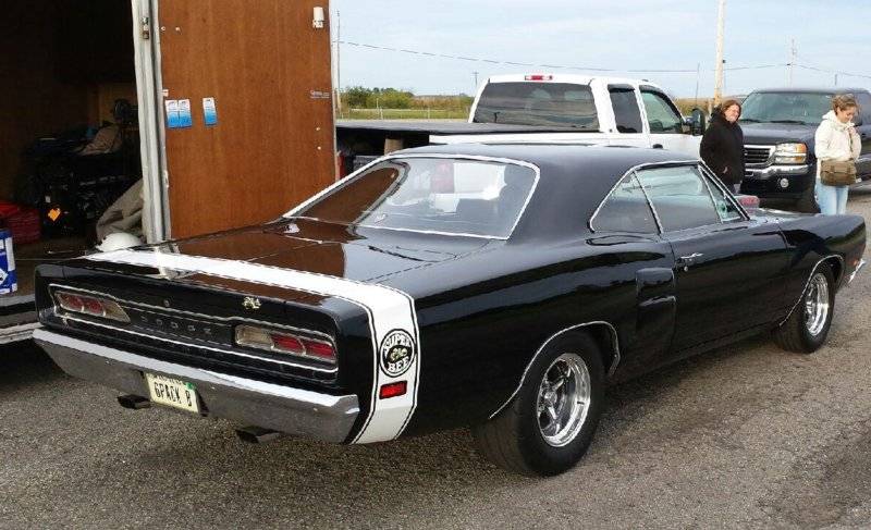

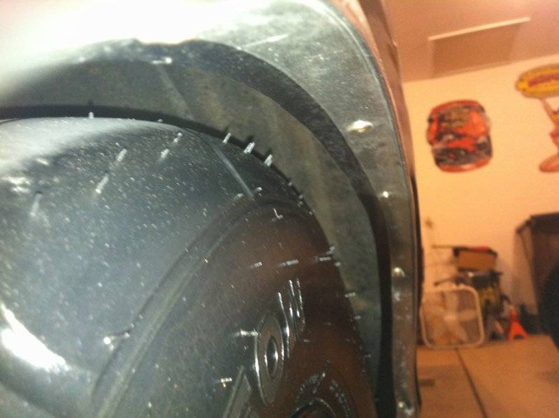

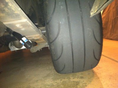

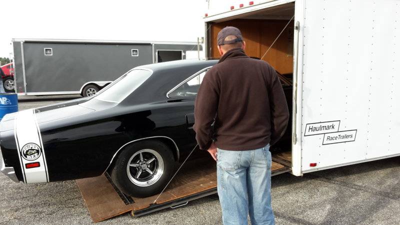

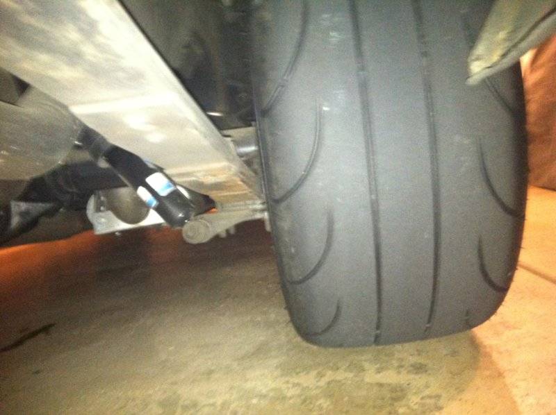

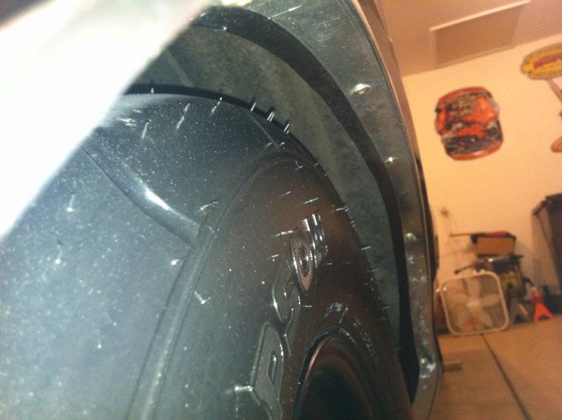

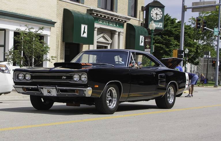

I'm running that setup on my 69 Super Bee, 10" wheel, 5.5" backspace (no spacers), with a 295/55/15 tire and that fits in the fenderwell. There's occasional inside rubbing depending on situation. I hear a rub when turning up an incline going into a gas station by me. And you can see the rubbing on the fenderwell, but not too bad.
Great to hear, thanks.Sure like to see a pic if you have one.
Here's some different pics of the 295/55 tires on the 10" wheel, backspaced 5.5".
