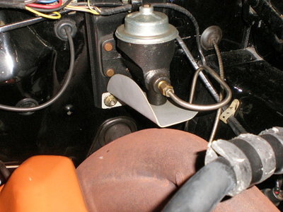

Also Q's @ that power brake set up. Will. M/W exhaust manis fit under it ?
I think it's possible to use the M/W manifolds under that power brake setup. Look how high the firewall bracket moves the master cylinder up, it's almost even with the top of the front fender.
They are this close to the master cylinder,if they would,heat could be a problem !
