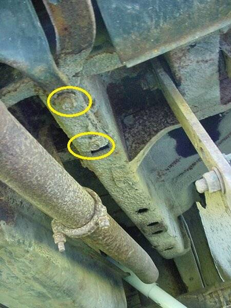

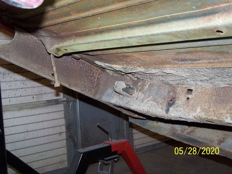

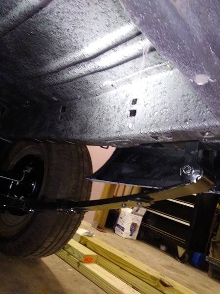

Could only find one pic using search- thanks @idrivemopar
But t looks like the place to mount the hangers isn't being used in that pic.
Looks like the frame rail has places to insert 2 clip nuts.
Is that not where the hanger goes?

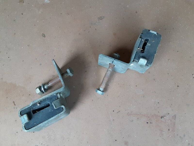

Anyone have a pic of the hanger?
I have a pair of tips I've been sitting on for years and I'm finally ready to put them on.
Thanks.

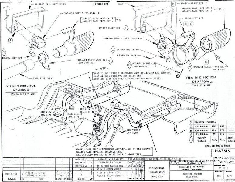

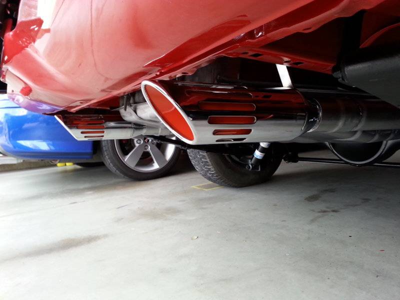

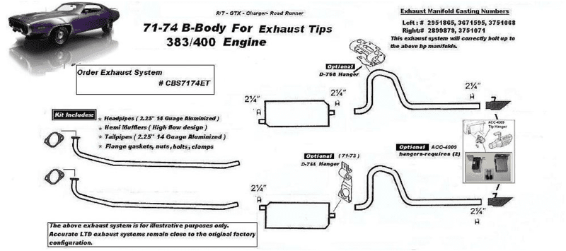

Those look about right to me. Hope this helps. From 1973 RR
Yep, same as my charger. Sorry just cant get picks right now which is why I posted the accurate exhaust stuff.

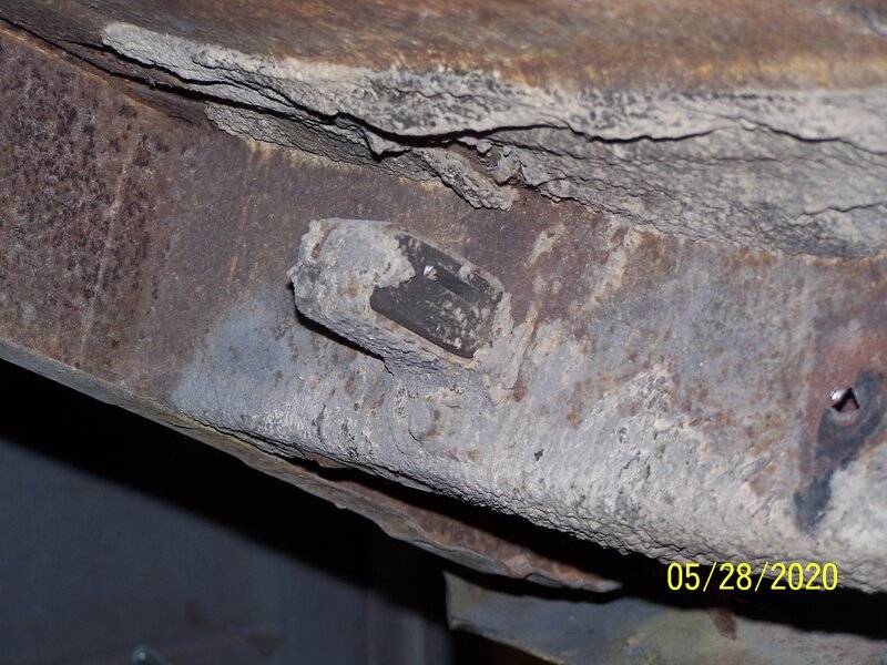

about the frame rail provisions for clip nuts underneath the frame rail. Those are for the Bumper guard bottom brackets
I think You car is 74... right ?
( Charger on pic, but I guess similar to Plymouths )
73, but nothing's ever been in those holes (that I can see, it's a factory undercoated car) and no lower brackets on the bumper guards.

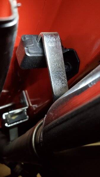

Here is a picture of the inside frame rail on the passenger side. Show the stock location for the tip hanger, and the other is the hanger for tti exhaust.

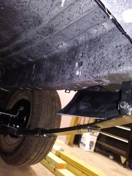

Just to add FWIW, I've replaced the passenger rail on my 71 Satty that originally had a single exhaust with a rail from a 73' RR that had factory dual ex. I left the u-bolt in the frame where the hanger mounts(got the hangers with the rails). Here's a few crappy pics but it isn't a self tapped location. I believe the location further towards the front about 10 inches or so is from differences between the charger/RR tips, or the resonator option. Not sure I could be wrong, dont matter to me...
The drivers side rail on my 71' is original and is identical as far as the "knockouts" in the rails for the tips/exhaust hangers...

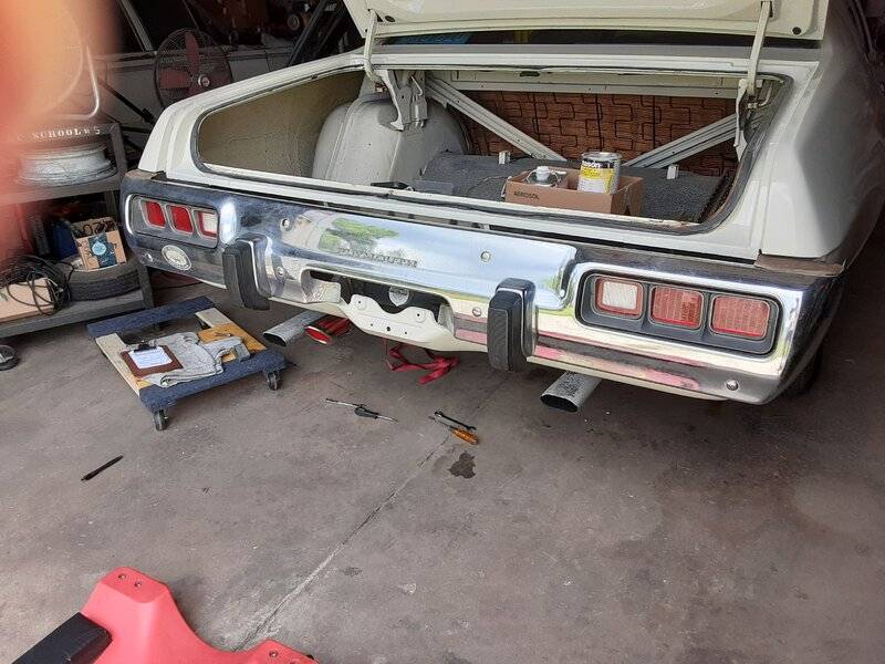

Well looky what I found in my exhaust parts stash-
Here they are mocked up.
I think they will work in the intended location after all.

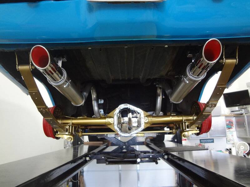

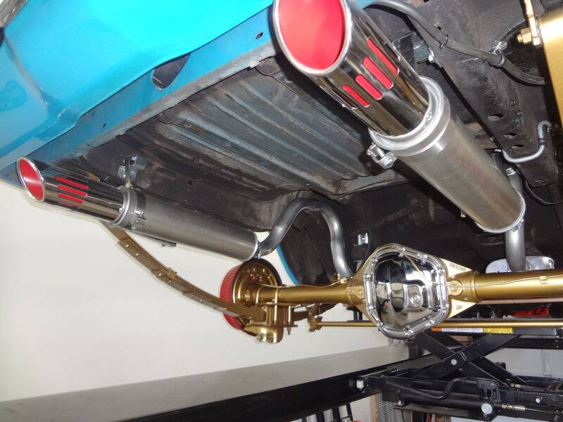

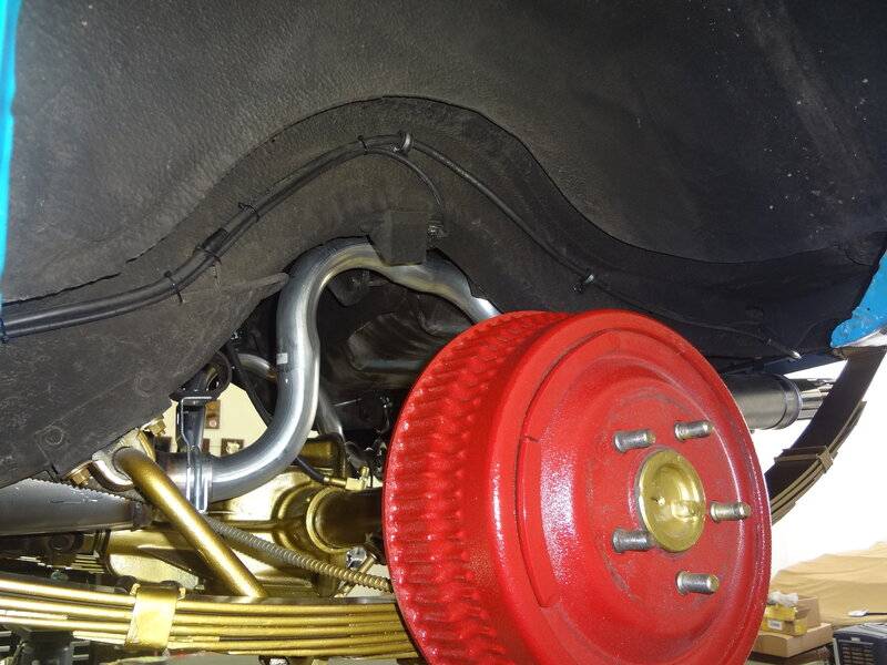

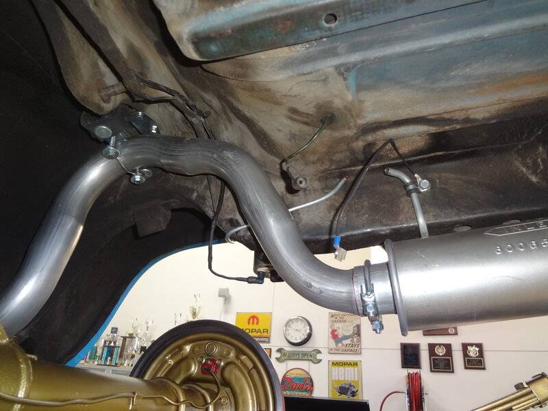

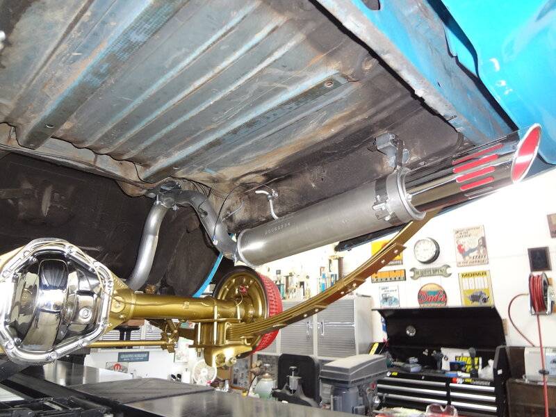

Here are pix of my 73 RR GTX when I replace my exhaust.
hope this helps.
