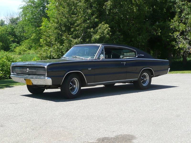

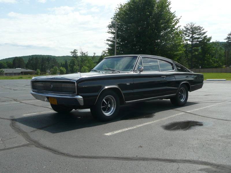

Going to try to send pictures of our car. First one should be Ludington Michigan 2016 coming home from the 50th anniversary of the Charger, then the new progress up until now.View attachment 901756
Nice Charger! What wheel tire sizes are you running in those pictures?
P225/70R15 TA 7x15 rim on front
P275/60R15 TA 8x15 rim on back.
If your springs are sagged, might have rub problem. I ordered MP hemi springs years ago, sagged more than my old springs. had the new ones made to duplicate factory. If I need to do another one, I would try adding a leaf. I have no problem with tire rub on the front, also easier to turn manual steering with narrower tires.
