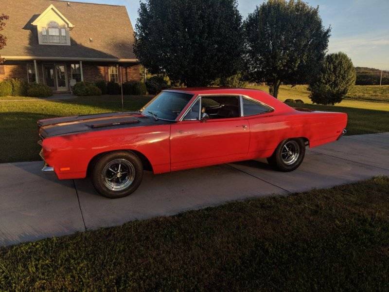

Actually I think trim rings came out on the 1970 and 1969 were chrome 500's?? Anyway here is 275 and 235 15's on my friends 69.

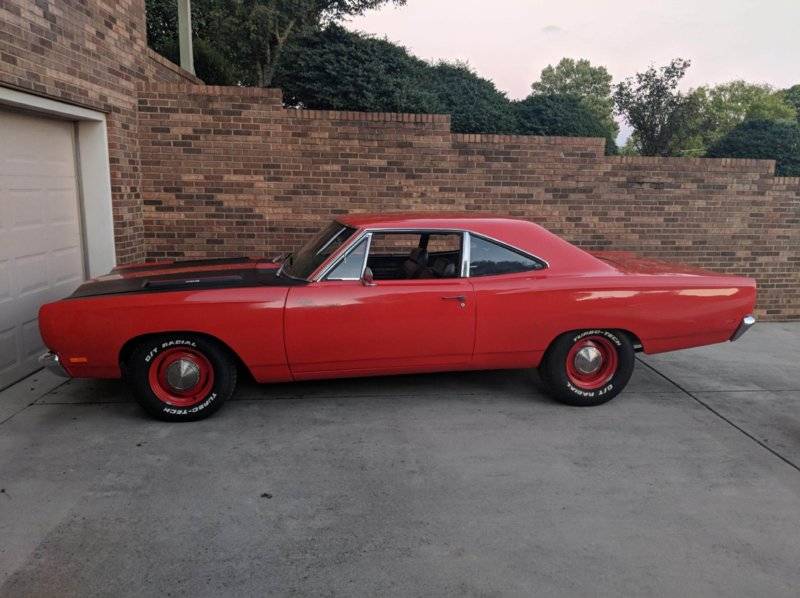

If you want to fill the front wheel well a little more use 225/70/15 tires. Same car with 70's on front.

The Magnum wheels in the pictures are actually mine. I let him borrow them so he could see what they would look like on his car and how the tire sizes fit. I am also putting trim rings on mine. When I purchased my wheels and tires I used what Hawk used on his 70 RR. Loved the look on his car from all the pics of his road trip.
