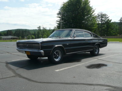

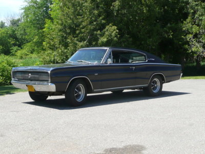

It so depends on the look you're after. It's such a personal thing. I prefer to not venture too far off from what they came with originally, and not too different if at all from front to back . I like the 27" diameter target. So that would probably be P235 70 15s all around, or the 235 70 in the front, and a P255 60 15 in the rear. Here is mine with both 235/235, and 235/255

That is the look I'm going for. I assume when you put the 255's on the back they were on an 8 inch rim? Is everything 4 1/4 backspacing? Any issues with the 27 inch height with clearance on the lips of the front fenders or on the leading edge of the rear wheelwell? I had an A body before and I had to watch the tire height.

Thanks for the info. My old car was a drag racer and I stuffed the biggest tire I could fit. This one is more of a cruiser so I think I will go a little smaller. Still haven't decided but I may go larger in the back just to fill out the wheelwell a bit more. This one looks a little small in the back.
The first picture looks like the wheels are staggered?
Sure they are all 235 in that one?

My 255s are on a 7" rim. The 235s on 6.5" rims. Never measured the back spacing.
Also another note:
I had 245/60/15's on an 8" rim (no offset) and they caught on the wheel lip molding. No larger than 235/60 on the front.
Don, you made me laugh. Yes, I'm sure. They've been on the car for, I'm embarrassed to say, 25 years. I'll post a couple more pics when I get home.
Maybe an optical delusion then...

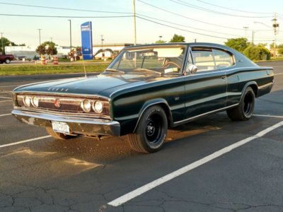

Our car at Ludington Michigan June 2016 on the way home from the 50th Charger anniversary in Detroit.
P225/70R 15 TA 7x15 rim on front
P275/60R 15 TA 8x15 rim on back
