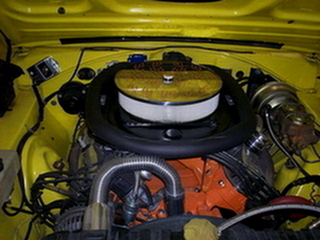

Thats a sweet looking 66, hows the ride on it? that looks just about right were I want mine including the wheels,thanks for the reply.
Thank you very much for your nice comments on my Coronet! It's ride is harsher than stock, because I used poly bushing when I rebuilt the front suspension, as well as using poly bushings on the Mopar Performance extra heavy duty leaf springs, plus I upgraded to a new set of the Mopar Performance .960 torsion bars and also added a set of KYB shocks on all four corners The front brakes have also been upgraded from the original 10" power drum brakes, to a new set of the Master Power 11" power disc brakes with the upgraded drilled and slotted rotors.
