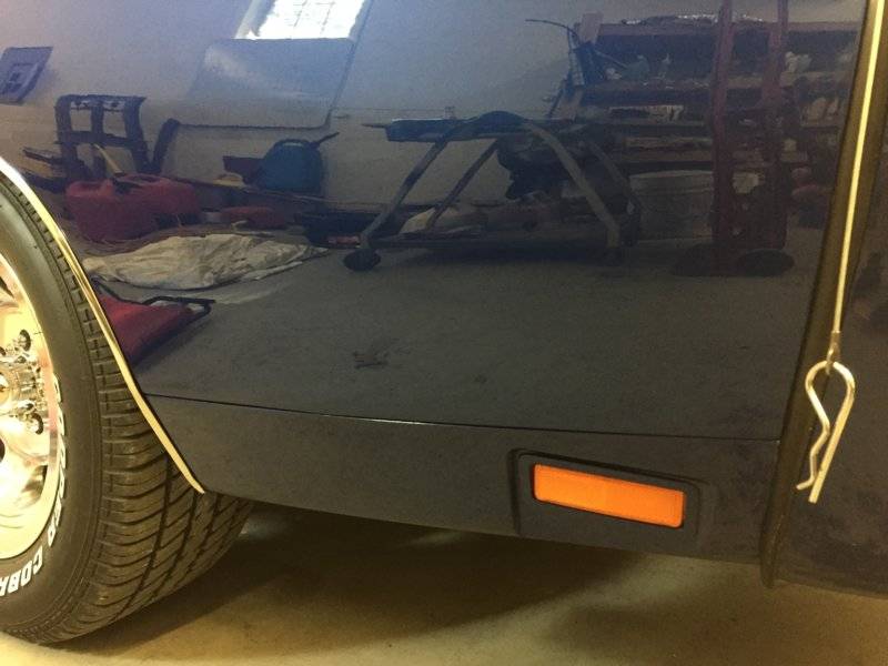

This is my front fender being modified for a Daytona front valence pan. I measured the width of the factory flange,and cut the fender that width below the body line. I had to cut a notch at the wheel well lip from the bottom of where I cut the fender to the body line. I used a pair of wide jaw vise grips and two pieces of flat metal stock to bend the fender on the body line.

Here is a pic of my clone. Who are you buying the front valance from?
It will take a lot of measuring and second guessing yourself before you cut the fender. As you can see from a previous post you want the leave a flap about 1-1/4 to 1-1/2" long which you will need to bend to have a fastening point for the valance.
