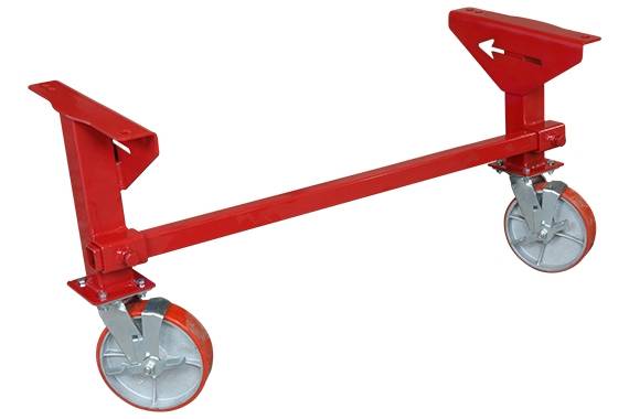

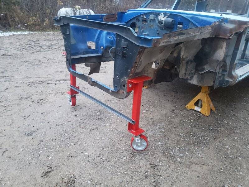

Why don't you buy/build a body cart for the front end so you don't have to assemble the K-frame
and all of the other parts?

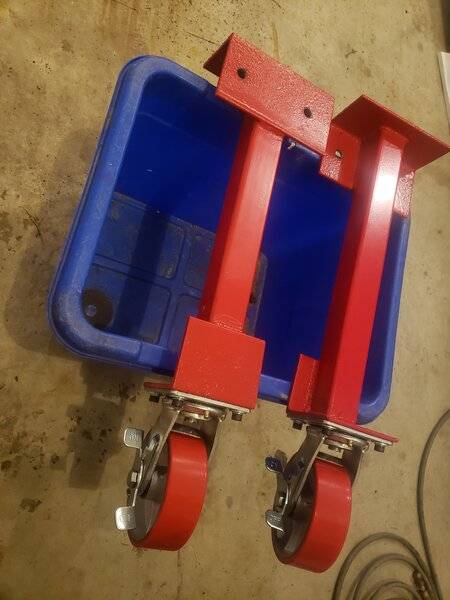

I made the same for my Challenger at one time.
