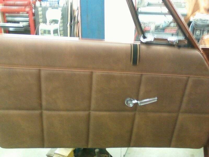

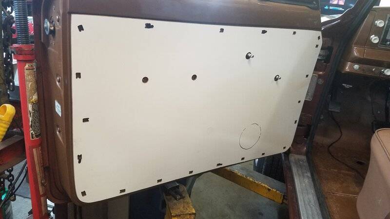

I've made them from Masonite and the original fiber board. You will need a Dremel or a drywall router to cut the rectangle holes for the retaining clips. You can pop rivet the steel sections to the Masonite. Just made these for my wife's 67 Gladiator. Its white faced 1/8" Marlite I had laying around. The 64 racecar are made from Masonite.

Did you make the "squares" by stitching or a heat deal??? Those look really good!
Mine is stitched. A buddy of mine built a die and pressed his. Actually worked good.
