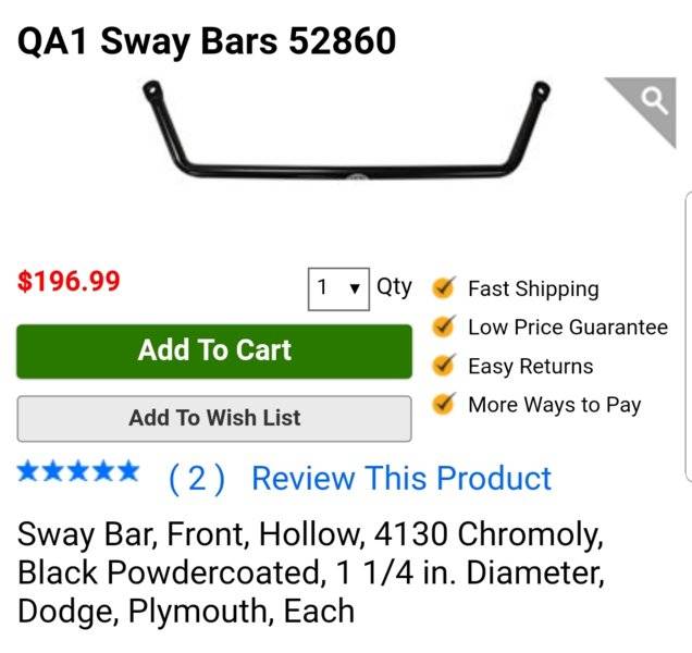

My factory sway bar won't work with their stuff, so I am adding their sway bar to the order:

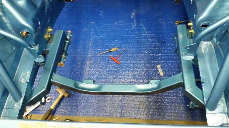

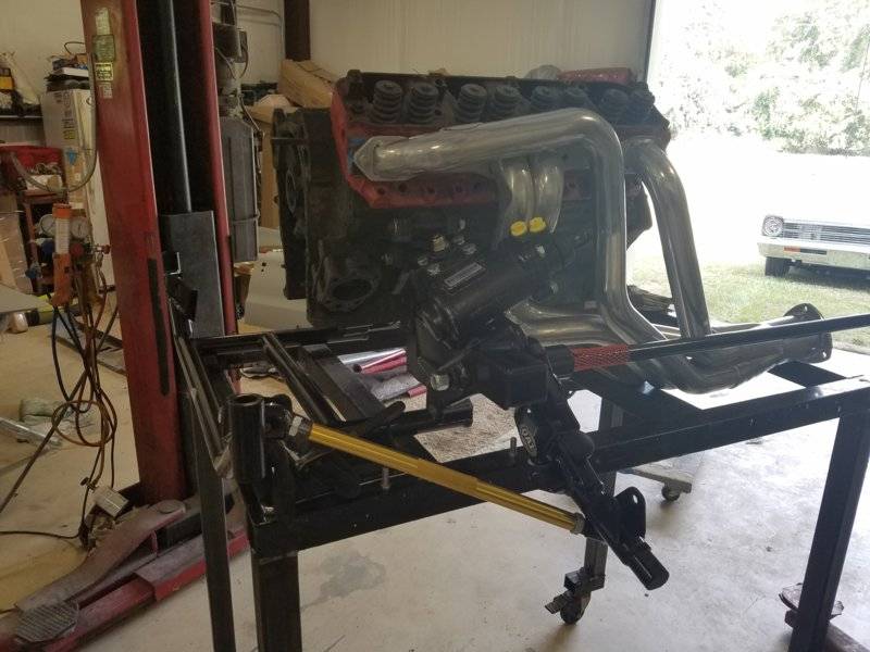

I have the RMS AlterKation kit under the front of my Challenger. Mine was free so now complaints from me. LOL. Long story but it was. All bolted right in. I like it because I was able to eliminate the torsion bars with the coil overs to use big tube headers & run a flat bottom dragster pan for 10 quarts oil capacity & plenty of ground clearance since my car site pretty low.
20150920_190437.jpg 20150922_184259 (002).jpg 20160414_201144.jpg rsz_1rsz_20160716_125311.jpg
View attachment 681687 View attachment 681688 View attachment 681689 View attachment 681690
Any weight savings with the alrerkation front end?
I didn't weight everything myself personally but if I remember correctly he said it was between 100 & 120+ lbs. Depending on options & the combination it was made for. Mine has no motor mount provisions or sway bar mounts or anything extra since I have a front & mid plate and mainly a street/strip car. Not a road course car.
