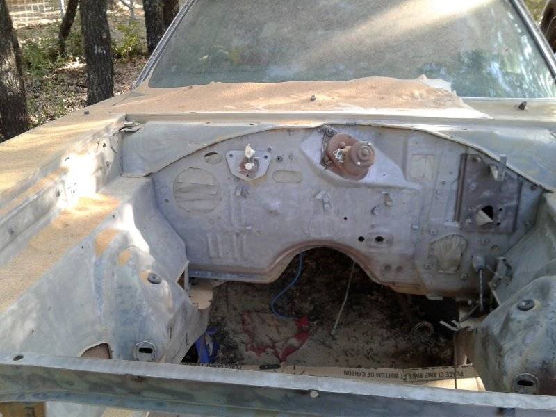

gonna have manual brakes which holes does the master cylinder go in it was a bare shell reason I'm asking for help,thanks
There is a stiffing plate that goes between the brake and firewall. Top 2 holes are for that, and the master cylinder goes in the 4 holes at the bottom. I hope this picture helps, this was my car 5 years ago before redoing it all.

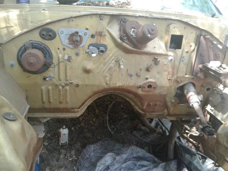

I went digging through my pictures and I found one without the master cylinder in the way, hope it helps too.
If you need one it looks like pirate Jack, dr diff, eBay, and a few other mopar parts sellers have them. Or put a wtb on the forum.
