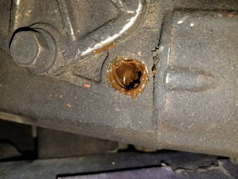

I'm a Newbie with a used and abused 69 Roadrunner we have owned for about 2 Months. After years of neglect I'm goin
g over things to make her healthy again. Long story short. I pulled the filler plug out of the steering box and this is what I found. It doesn't look right to me.
Any ideas how I can flush this box and replace with new fluid ?
They tend to leak so people stuff the box with grease instead. Expect it'll leak if you clean it out and fill with gear oil. Oil is the proper lube but I believe people here will tell you the grease works ok for them.

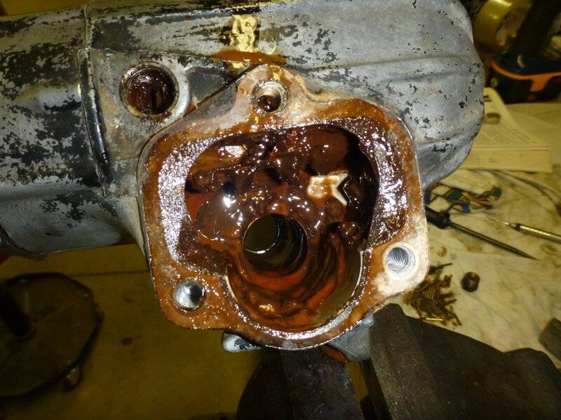

That one looks pretty.. here's my OE that had never been touched in 48 years when I restored it..
