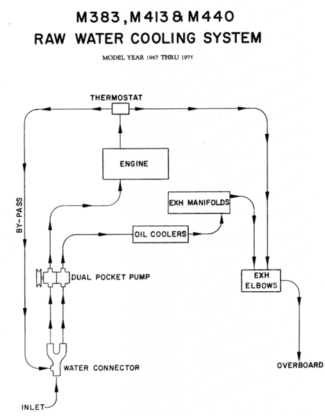

I would be very leery of a marine engine. Lots of corrosion and just not my choice for a starting point. If free maybe worth the time to tear it down for inspection. About all that can be possibly used is the short block. Heads and intake most likely HD industrial application.

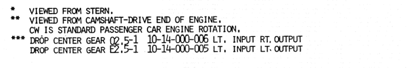

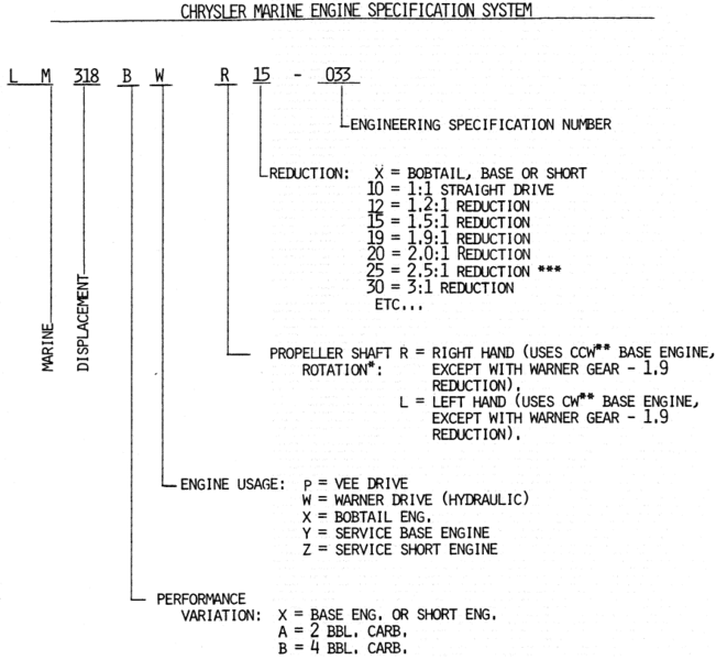

You have to be careful with marine engines because some spin in the opposite direction.

Corrosion can differ depending on the cooling system used and where used. I wouldn't use any salt water engine.
The problem with reverse rotation engines is that they have some specific components that make it unsuitable for use in a vehicle. The cam is ground backwards, the distributor is backwards and the crank is often different. The rear main bearing surface on some engines had serrations in the crank to pull oil in away from the seal. If that crank is spun the other way, it pushes oil toward the seal and increases the risk of a leak.
As stated above I have a marine RR in my car and the crank rear seal area had to be polished or it will just spit the oil out.

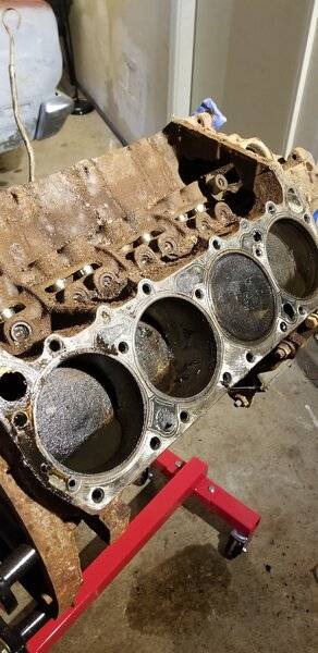

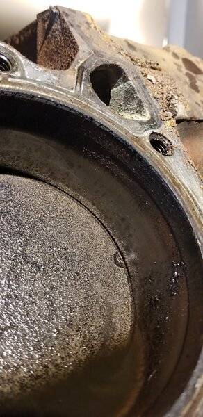

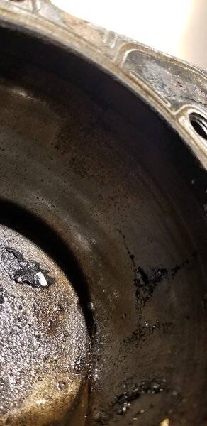

So, as an update, I pulled the heads, and the bores look really rough (pictures below). It has big ridges at the tops of the bores, and it hasn't loosened up any after nearly two weeks of applying penetrating oil. There was sediment in the bores when I opened it up, too. I'm really thinking the engine requires extensive machining, which is out of my budget. Based on the pictures and what I've described, does this look salvageable? (edited for picture formatting)
People put bare blocks out in the weather to season.
Find someone with an oven and bake it.
It's a 1969 RR, and unfortunately it is a numbers-matching engine....
What does the pad under the distributor read? I myself, would try to free it up to determine the deck height if it's still at 4.25" bore.
That wouldn't stop me from pursuing another though.
just turn it upside down and take the easiest rod loose and drive the piston out with a hammer and a board, repeat
all you really want is the block and maybe the crank then you take them down to your machine shop and he'll check the worst hole and see where you go from there
Block will have to be cleaned anyway. That is why I suggested baking it. That rust and caked on oil will be gone when it comes out.
