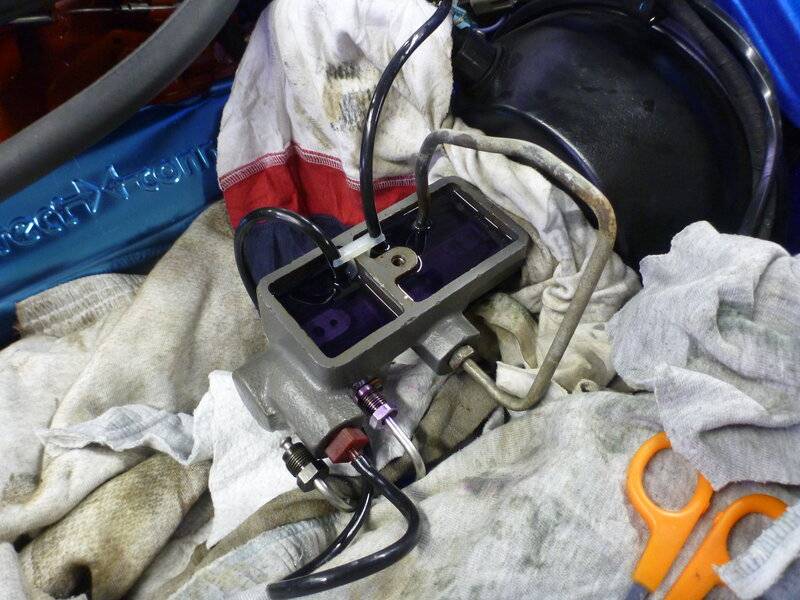

Air in the nose of the master. Only way you'll get it out, without taking it out of the car to bench bleed.
That can be true. Common mistake a lot of people make when bench bleeding. It takes extra effort to press both pistons which most people unintentionally make.
