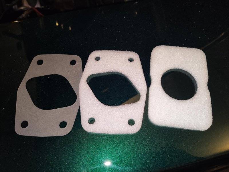

I got a paint gasket kit for a 1970 Charger that included these 3 gaskets for the master cylinder to brake booster. Unfortunately there's no mention of how they should be installed. My master cylinder is leaking where it bolts to the booster. The 3 gaskets include a grey paper gasket and 2 foam gaskets. I'm confused how these should be reinstalled after I bench bleed the master cylinder.
No gasket goes there.
I wonder why they'd make a gasket that perfectly matches the shape of the master cylinder mount point? Plus, I'm already leaking there so simply removing and reinstalling the master cylinder with no gasket would probably not solve the leaking.
I believe on power brake systems, there are two gaskets. One at the firewall (the same for both power and manual) and an o-ring, between the booster and the master cylinder.
IMO, the master cylinder gasket at the firewall doesn't really do any sealing, nor stop or prevent any leakage, it just insulates. You want this gasket installed, yes, but if you're seeing leakage, I suspect you have a leaky M/C in need of a rebuild.
The white foam gasket, with the trapezoidal hole, and four bolt holes, is the common gasket that goes on the four bolts coming through the firewall holding the booster (on power) or master cylinder (directly on manual) to the firewall.
The paper gasket, just like the foam one, is an alternate you may choose to use. The other white foam gasket with the round hole is also an alternate to the first white foam gasket, if you choose to use it. Often we match the new gasket to the old one on install.

They go on the front and back of the booster support plate?

The gasket is for manual brakes to seal the inside of the car from the engine compartment. The booster has a gasket where it mounts to the car also.
Yes the factory bolts a disc brake master cylinder to the booster metal on metal

one on the right I dont remember ever seeing.
middle is between master cyl and booster ( or between master cylinder and firewall plate for manual brake cars ) , paper gasket on left is alternate for the middle one, but most commonly power disc brake cars
ps, the gaskets are to keep dust and water out , If the master cyl is leaking thats a problem
There is also a foam gasket between the booster to firewall plate and the firewall itself

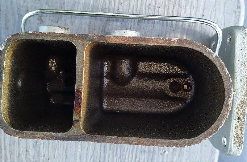

I haven't had time yet to remove the master cylinder, I want to check the bottom and see if it's a Bendix or not. My car is a power drum/disk brakes car. I can't remember if the m.c. was every replaced, but I removed and refinished it myself about 15 years ago, painting it with Rust Bullet, which gives it a nice silvery-gray color that's super tough. I think Rust Bullet even holds up to brake fluid. When I either rebuild or replace the m.c., I'll probably switch to DOT 5.
When I pulled the cap, I noticed that only the rear pot (front brakes) was leaking, the front pot fluid level wasn't changed.
I pulled the master cylinder today and looked on the bottom, it appears to be a Bendix 22268 but not sure about the last two numbers...2226824 perhaps...anyone? This is a good one then, not a repro, from what I've learned. The piston diameter is over 1"...I'm thinking 1-1/8". I looked for rebuild kits and only saw a Dorman one on RockAuto but that's for a 1" bore. Looking at replacement MC's, I'm mostly only seeing those with the line fittings on the driver side, not the engine side like mine.
