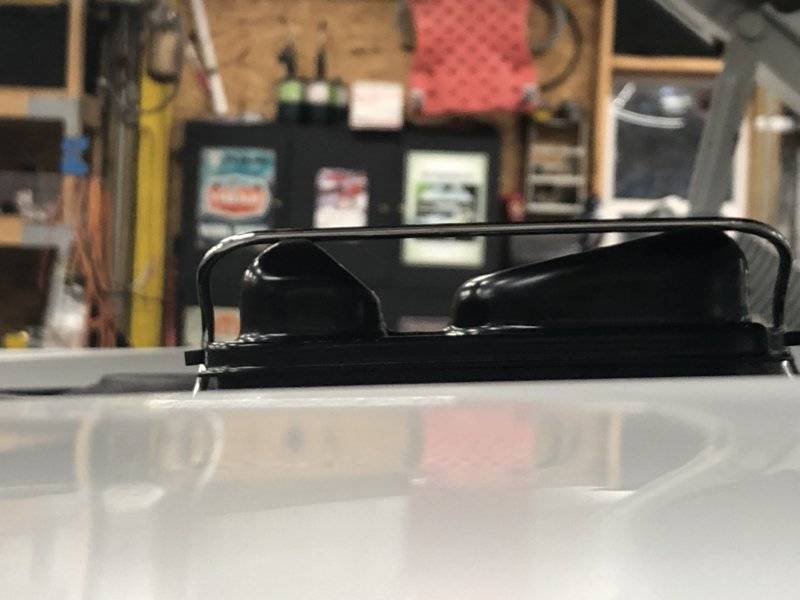

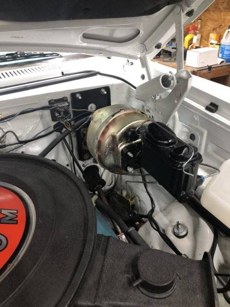

I’m in the process of converting a 65 satellite to front discs. I’m having an issue with the master cylinder being too tall. I previously added a booster with the drums but the master that came with the front disc kit is about 1-3/4” taller than the other master cylinder.

Ok. The master in the photo is for disc brakes. So now I need to find on that it 1-3/4” shorter while still being for disc brakes.

View attachment 778876 View attachment 778877 I’m in the process of converting a 65 satellite to front discs. I’m having an issue with the master cylinder being too tall. I previously added a booster with the drums but the master that came with the front disc kit is about 1-3/4” taller than the other master cylinder.

You seem to have an odd collection of parts there. Did you buy those parts separately or was that a kit? You might have some GM parts mixed in there or something. I've never seen a MC sticking up that high on a Mopar.
Says it is for a Mopar but it doesn't say it is for an early B body car. I'm thinking you have the wrong parts for your car. You might want to post this over in the '62-65 section and get some help from some early B body guys.
I think the master cylinder you have is a very tall one. I believe there are other ones that are not so tall, maybe one will fit correctly.
The problem is the linkage bracket raises the booster which has raised your MC too high. That set up is for A body type. B body used dual Bendix booster mounted right to the firewall via the flat bracket. The MC you have would be the correct type for 67 B and 67-69 Hemi with disc brakes. Brake lines to fender.

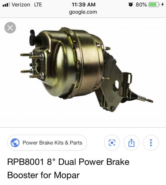

Can you point me to a repro? Like to see what you’re describing before shelling out more dough.

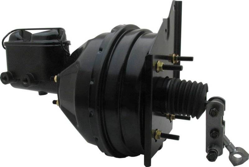

This is the Pirate Jack Reproduction. This is what a B Body non hemi would look like, except the MC Ports are towards engine for 68-70 B body Non Hemi. The back plate is a disc version with round hole vice oval, but otherwise it keeps the Booster at the same level as MC, not raised like the hemi and A body bracket assembly does.
