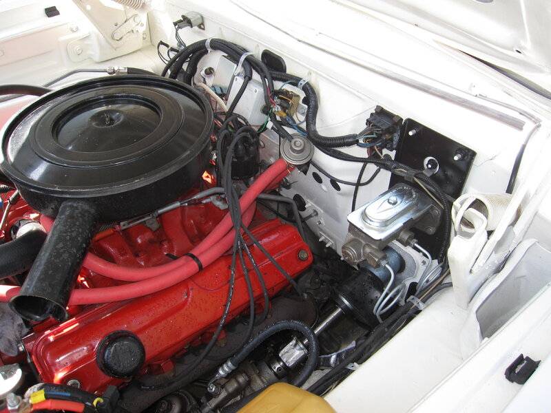

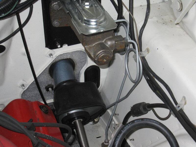

I went to a dual on my 65 Coronet. Used a Rock Auto part as it was 1/2 the cost of a single unit! I did build my own lines.
Mike

View attachment 1236916 View attachment 1236917

HI Mike Would you know the master cylinder part number?
