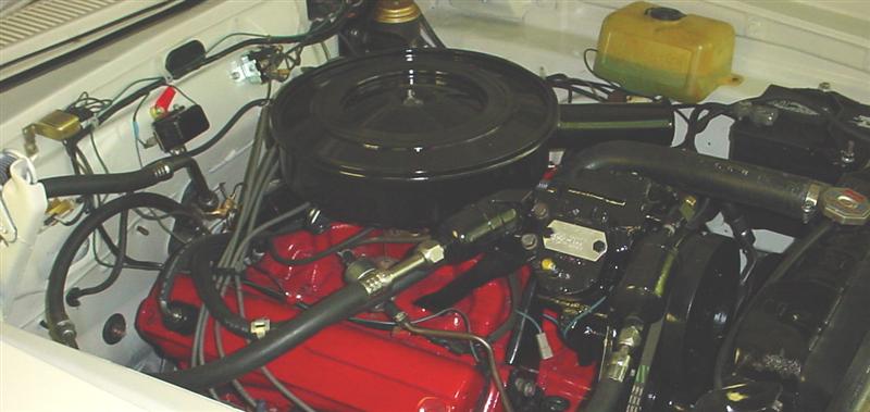

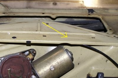

location of cowl body number for 3rd gen b bodies , I've noticed they seem to be left out of most of these sort of threads . still can't figure out why :eusa_think:
