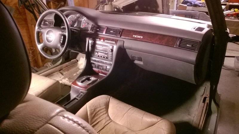

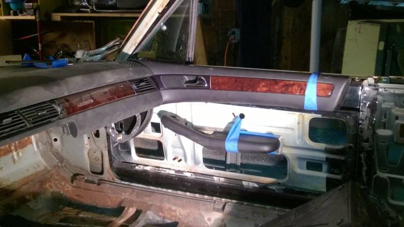

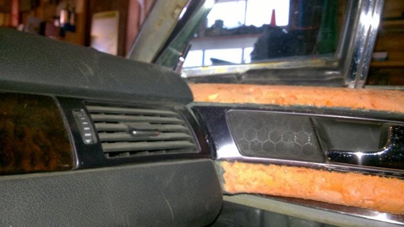

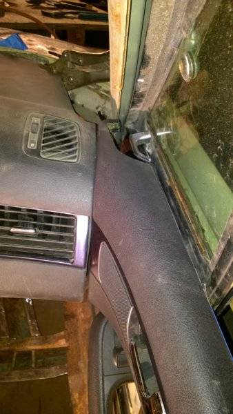

I do not. Yet. Here's one of the expanding foam design that I have scraped that shows the shape I need to make. And another of the door with the unit installed that curves out towards the dash . So I need something to replace what you see in foam, to go around and under the curved unit on the clean door. You can see that I cut out the portion of the plastic door panel that goes under the curved unit end to mate up against the dash end contour. I used it as a guide to shape the foam. Matched up okay but the foam just isn't solid enough to cover with fabric or leather. So, I need something more solid to shape it out of.
Ahh, I see. so this is almost like a fiberglass job. You need a good one, whatever it may be, to make a mold. Once you've done one, then you can pour as many as you need, even if you wanted to pour (if you can call it that) foam or your material of choice, then pull from the mold and shape it with a electric turkey slicer.
I need two, one in mirror reverse, one for each door.

Is that Sebring interior, going in a B body?

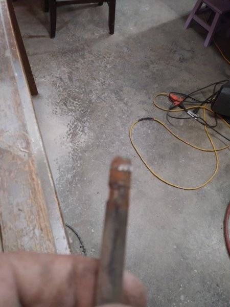

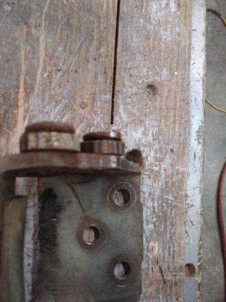

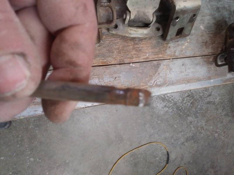

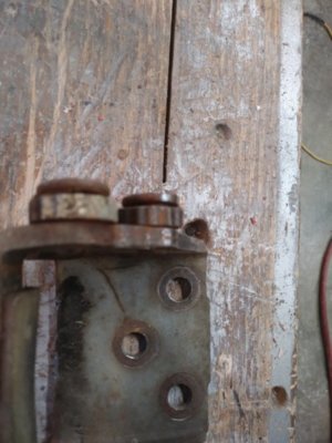

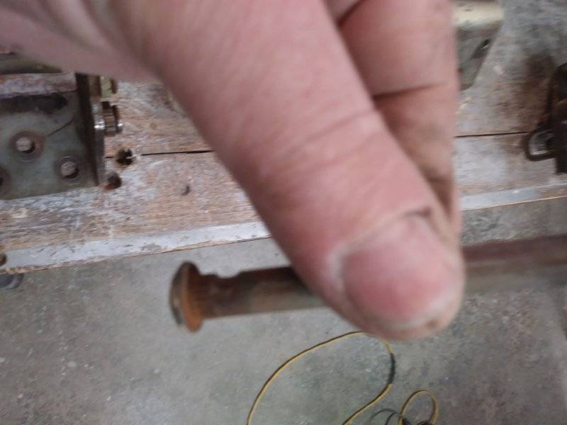

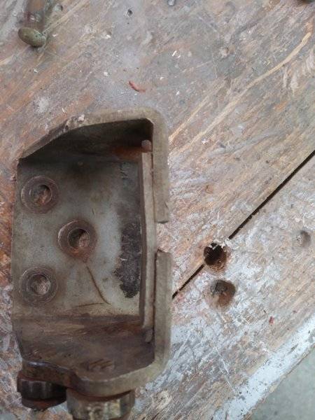

The door hinges. The left has a missing wavy spacer in one of the little gear wheels. The wheel wobbles around. The pin is worn top and bottom. As are the holes. The section with the plate across it is bent.The right side is in much better shape with only a tiny bit of wiggle.

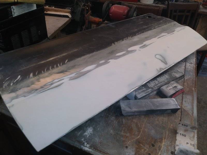

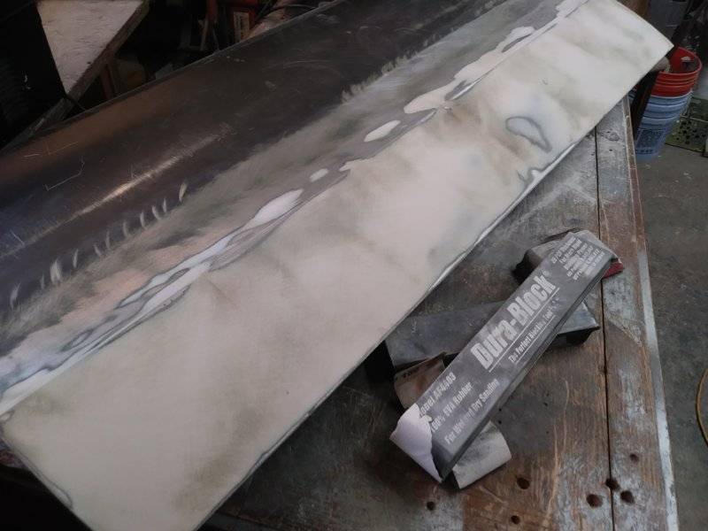

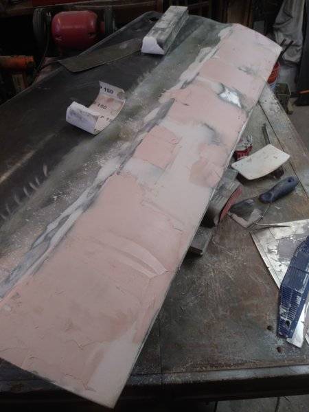

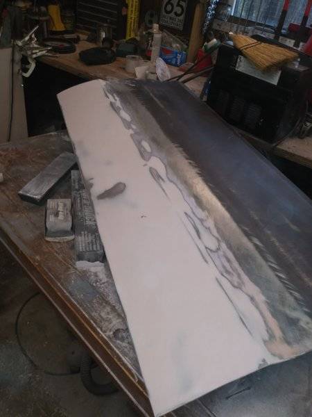

The bottom section of the door is in the second coat of filler after having been sprayed with guide coat twice.

I have a good set of hinges - pretty sure they're the same '66-'70.
As for your panels, do the foam thing and then 'glass over the foam. Forget making molds - too much trouble for a single part.
