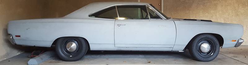

I've done 1 to 2 inches below factory spec ride height with no issues and usually no alignment adjustment necessary.
Just watch for wear on the inner treads.
I've got Hotchkis leaf springs on my car ('69 RR) with FF 1.06 T-Bars, lots of other stuff as well.
My bars sit about 1" above the bump stops.
I also have the Hotchkis/Fox adjustable shocks on all 4 corners, they are much stiffer than the Bilsteins I had on previously so maybe I can drop it lower but I don't really want them sitting on the bump stops.
