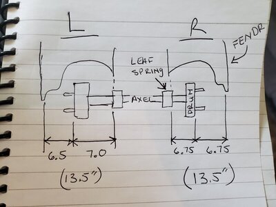

So... I know I'm beating a dead horse here. Reading through many posts about tire sizes on cars. I understand everyone should take their own measurements, so i did. I'm going cross eyed trying to sort out what Back spacing & max tire I can squeeze in that would be optimal on the REAR only at this time.
Holding no one accountable, from experience what should I expect to look for regarding a rim size OR do I pick out the actual tire first and find a rim from that I think I'm doing it wrong.
My Measurements on my poor drawing below for my 1969 charger. Any insight would be appreciated!!
It's a pretty good drawing actually.
My 2 Chargers have 275/60/15 w/ lots of room to spare on 8" rims, w/ approx. 4-4 1/2 backspace.
That is the sort of standard as I am sure you know.
I am always looking for 10" rims w/ the correct backspace (4 1/2- 5 1/2?).
Tires also seem to go up in price dramatically after 295/50/15 fyi.
Good luck.
I suggest taking another measurement. Take the outside measurement higher up in the wheel well. On my '66 Satellite the tire contact point was well up in the wheel well, not the lip. Not sure what the '69 Charger out wheel well looks like. You need to pick both the tire size and rim backspace at the same time. Get the overall tire section width, not just the tread width & diameter ratio.

yup i have this. my current wheel is 4" from that bump. never rubs. She sits pretty high with the HD leaf springs. although i'm not opposed to removing or modifying the bump if it causes issue with the new set up.

First, I would pick a wheel diameter. It really doesn't matter, because you can get a 15"wheel with a tire diameter of 26", and a 20" wheel with the same tire height. I say to start with the wheel diameter so you can shop for available backspace.
Next, decide on a wheel width, keeping in mind that a given tire will have more section width on a wider rim. An 8/8.5 width is fairly easy, assuming the backspace isn't crazy one way or the other. A 10" width is a lot harder to fit.
Now, looking at your diagram (which is not bad at all, btw) I would have said you need 1/2 more backspace than half rim width, then I noticed the rear isn't centered. But that is a roundabout way of saying..... you are centered in the passenger wheel well, so you need a centered wheel.
Some younger guys like the metric offset bullshit (I'm old, I dont) but yours is easy...zero offset. Shop for zero in whatever width, you should be good.
If you use backspace, remember that bs is measured from the back edge of the wheel, but the width is measured between beads, so an aluminum 15x10 is really eleven inches thick. So a centered 15x10 would have 5.5 backspace.
What tire to choose, is ENTIRELY dependant on which wheel you choose.
(Long way of saying, I agree with beekeeper, that's about the max you are gonna get under there, and having the open wheelwell of a charger, and the *** in the air sure helps. A low-sitting rr is much tougher)

so if i utilize those measurements and go by mine , using the minimum measurement from each side (6.5" from drum to inner fender / 6.75" from drum to leaf spring) i should have 1.0" fender side clearance & 1.5" inside clearance to leaf spring.
am i doing it right ??

i found similar wheel at 17x9.5 with 5.56 BS that should fit that tire better. it still has a 3.27 center bore and offered 17x7 (4.0 BS) for the front so will fit my brakes. using my bad math skills. i come up with 1.19" clearance to the leaf spring & 2.56" to the wheel well. American Racing said it would fit according to their scale (for what ever that's worth) they mentioned to add another 1/2" each side for the lip cutting down to (0.69") + what ever the tire budge would be (about 0.34") ... am i cutting it too close on the inside or am i going to have .35" gap?

That 17x9.5 should also work, though it should be a bit tighter than the eight inch (obviously). Remembering that it is really 10.5"wide, it has an extra 1/4" offset to the inside. That should be insignificant on the pass side, and desirable on the drivers side. And I always prefer the taller tire, they just look better on our cars. But again taller or shorter tires work just like a rear gear swap. Example, if you're running 2.76, you would want a short tire, for some extra go, if you're running 3.91, the taller tire can tame the gear down. 3.23s, you can choose either. Either 275 should have the same section width. I personally would choose the taller tire.
The 17x8, with a 245/50x17 would probably fall on your car, its snug on mine, but my 57 wheelwell is quite a bit smaller than yours.
