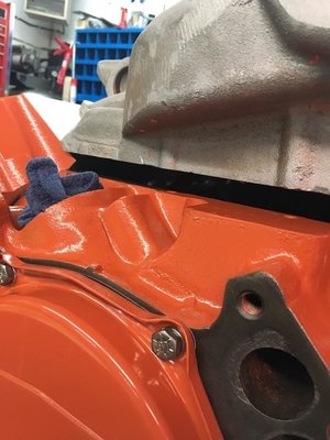

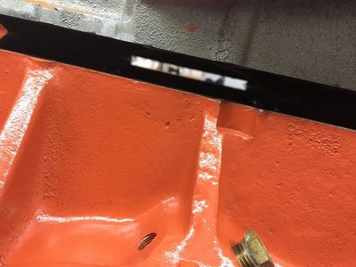

Hello, I'm building a 64 Belvedere max wedge clone and my question is: I'm using a 73 RB with Indy EZ-1 heads and a 64 Max Wedge intake, when I set the intake in between the heads there's about 1/2" or so gap at either end under the intake. Is this correct and is a valley cover the solution? When I pulled the motor out to do a refresh there were Edelbrock RPM heads on this motor and there wasn't a gap under the intake but now with the EZ-1 heads there's a gap. Any help would be appreciated. Thanks, Mike

The ports on the Indy heads are raised from stock position. You can use an Indy valley cover or make spacers for the end of the manifold. I would use the Indy valley cover because it will keep the hot oil off the bottom of the manifold.

There's nothing wrong. As I said, the ports raised so the intake sits higher.
When Indy built this head they raised the intake ports. In order to allow a stock dimension intake manifold to fit, the intake face of the head was extended. Causing the intake to set higher. The valley tray fits under a cross ram easily. I would recomended rounding off the bottom of the outer carb pad ears. That will allow valve cover removal. The exhaust ports on the -1 heads are also raised, EZ are in the stock location.
