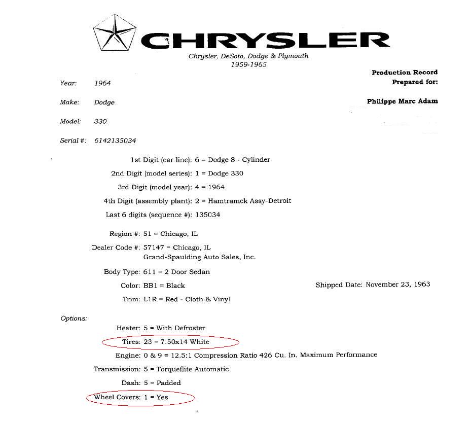

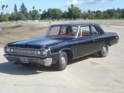

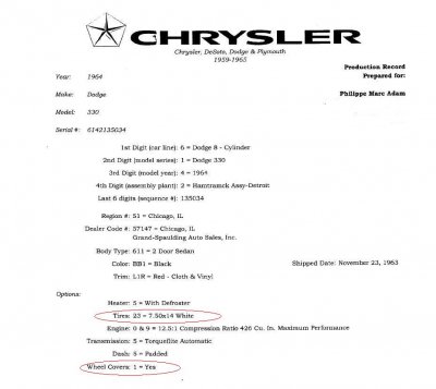

My max wedge lightweight was ordered with 14x7.50 white walls and wheel covers and the wheels are stamped 14x5.5"
