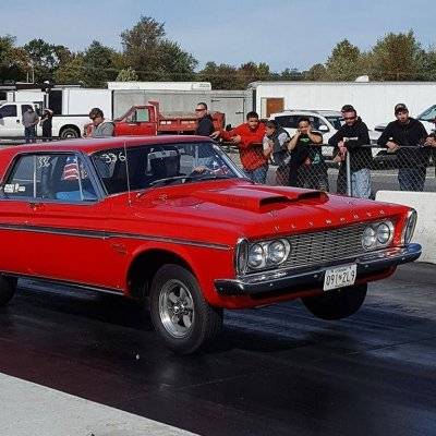

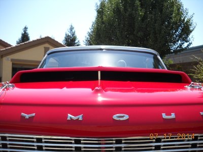

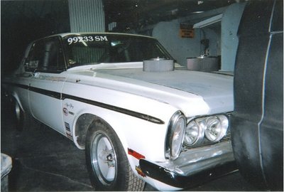

this is how i cleaned up that issue , the scoop is to short off the hood . air hits the end of the hood , don't go in the scoop . it goes over it . carbs get fresh air now .
  • scan0007.pdf
I have kind of wondered that the scoop being too short and stuck in the boundry layer of air. Although I like your adapt and overcome attitude :)
well i'm always looking for a solution to an issue . the next type scoop that was used is the hemi one . its much taller and has a bigger mouth opening . could do the center headlite thing , remove them and bring that grille air up to the carbs like ford did , sorry for my language . i can get cared away , lol . in had some talks with a scoop designer , he said air at like water . put any thing in its way , it climbs over it , least path of resistance . he claimed that there is ways of capturing the air for a supercharging effect . more air then space for it thing . but it was to modern looking . not a vintage look at all . so i hung them in the wind . he said '' thats get them in clean cool air '' , don't think he liked my solution . lol .

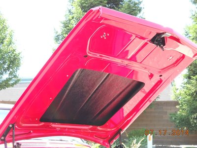

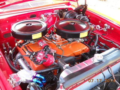

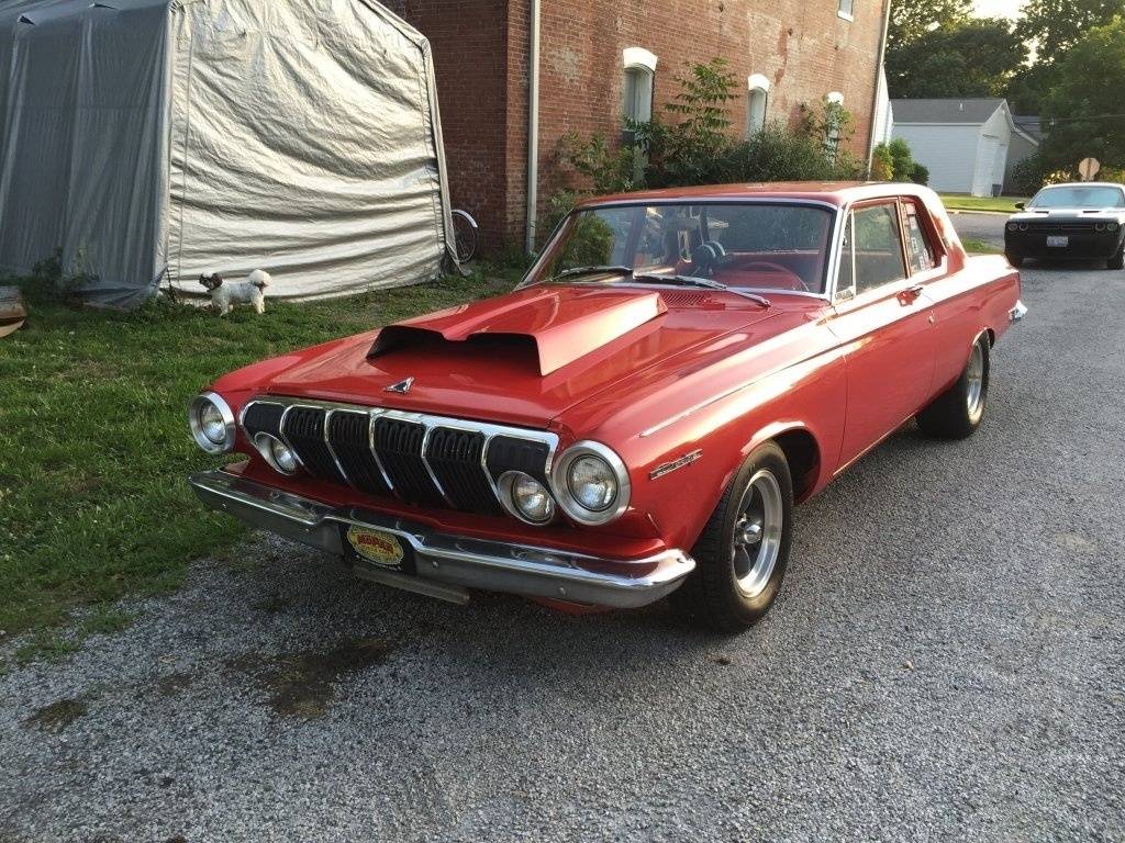

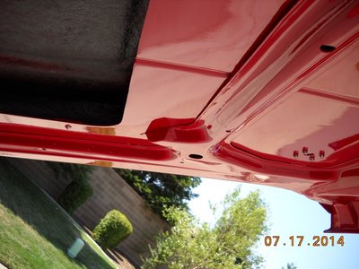

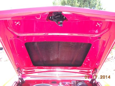

On my car the 63 scoop would not cover the crossram 13" air cleaners, so here is my solution: Later hemi scoop and a large cut-out that allows me to use 1" phenolic spacers under my carburetors (now, FiTech throttle bodies). Not posting the brand of scoop as it required extensive work to get it to sit flat and be symmetrical, side to side. I had a post about it a couple of years ago.

i saw that your scoop has the middle support bar in the front. If I use the short hood chrome off the Savoys do you think it would fit or would this bar be in the way? if not ill have to cut my middle support out so the chrome fits.
I added that stainless steel center support to give the scoop extra rigidity. I thought my hood looked better without the center trim piece. How long is the Savoy short trim piece?
