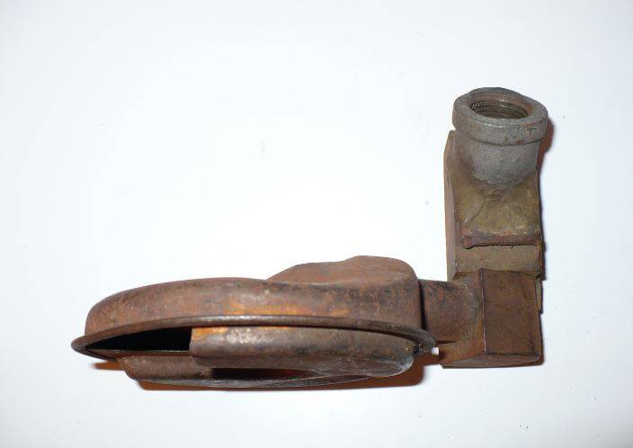

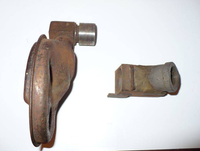

Where do you get the pickup tube?
Think they had a tube with a swivel pickup. Tube removed before I got it. Sold it.
you don't with out spending big money on something obsolete. the 70-71 hemi pick up works fine & is what I've used in the past.

Hey chooch, have you actually seen this pan, and checked it out, or just looking at it on line, and are you saying the '70-71 Hemi oil P/U's will do the job on a wedge block ? I may go with this set up, as my engine is still in pieces, awaiting assembly, Thanks...
the 70-71 hemi/6pak pan won't fit the 62-65 chassis. if one has the early b-engine pick-up it can be made to fit. the swinging pick-ups were 63-64 super stock. anyhow, perfect or not the new pan is a step in the right direction for early b-body people.

Has anyone tried this new pan in an early B body yet? On maxwedge.com they say the mopar oil pickup part #P5249817 should fit this pan. Has anyone tried it?
Thank
I've looked up the Oil Pick Up, P#5249817. It lists as a 1/2" tube, and normal application is for a "B" Block. Can anyone verify this is the pick up that will work with the new MW pan ?
those pans came with a 1/2" pipe swinging pick-up. I wonder if maxwedge.com is looking at a street hemi 1/2" pick-up. if so the sumps would be in a different location, plus the 63-64 super stock wedges were the only ones to have a 1/2" pick-up, and all other wedges had a 3/8" pipe pick-up. I think the longer (horizontally) 62-65 3/8" pick-up could be made to work.

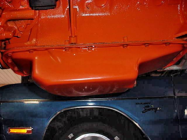

This is an original Max Wedge pan that I bought years cheap off of a friend 15 yrs ago,didn't use swinging pick up,used Hemi 1/2" pickup with no problem.

62MAX, Do you happen to know the capacity that this pan holds ? Since my build will be a stroker, I wanted to get some extra oil in it, compared to a stock 4qt pan, Thanks...
Another thing comes to mind now, with this new pan option. Is there any need to trim back the K-member on the '63-'65 V-8's for clearance, as we all have been doing when using an aftermarket pan ? I believe it was the right corner that needed some extra room ?
