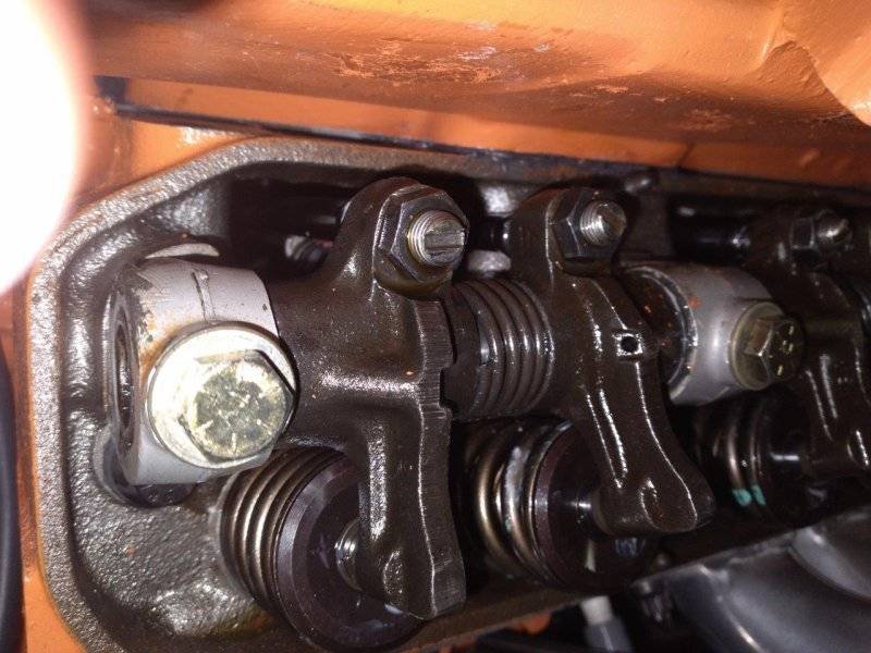

I'll be trimming the baffles for clearance, see attached pics for posterity for future reference. This a 0.570 lift solid roller and Isky ductile iron rockers.

I thought about that but these 4 bolt covers are already prone to leakage and these are not the specific MW valve covers, just generic early 4 hole units so I don't feel bad modifying them. If they were the real deal I wouldn't cut them.

Do you have the original adjusters on the rockers? I have seen many that were replaced with longer threads. Do you have any pictures?

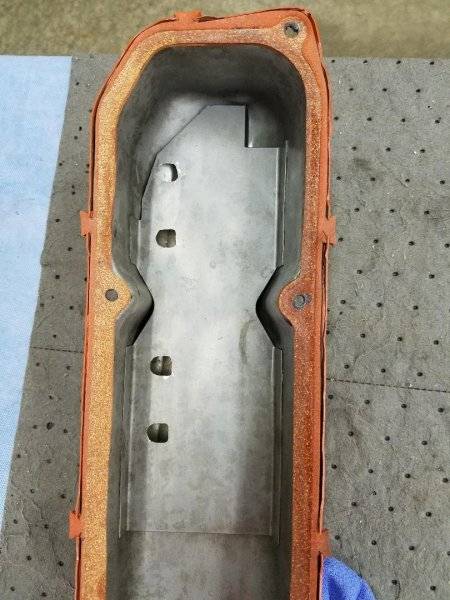

Had to take a second look. They're just hitting the baffle. Easy fix, remove the baffle.

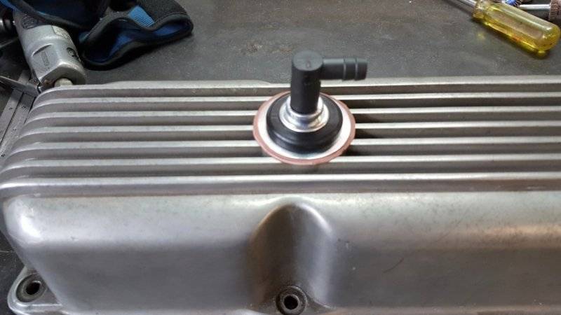

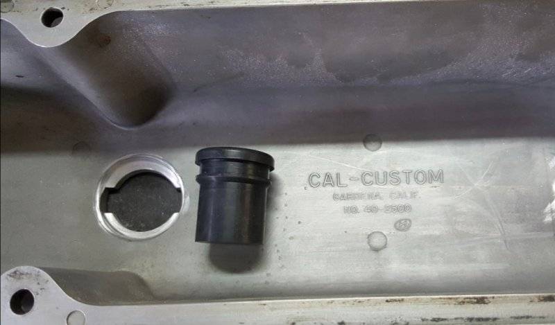

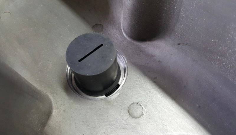

If your using a PCV valve there, there's a baffle insert you can use. My Cal Customs didn't have a baffle. I found one of these, I think on Summit.
Not going to be using a PCV valve, yeah the baffle is going bye bye.

I run the 1968 valve covers on my big block with offset Mopar intake rockers and Crane Gold on the exhaust. I had similar issues with the baffles in them, but I wasn't interested in cutting them so I took a torch and warmed the areas they touched and tapped those spots in with a ball peen hammer. Personally I wouldn't cut the baffles out. They are there for a reason.
