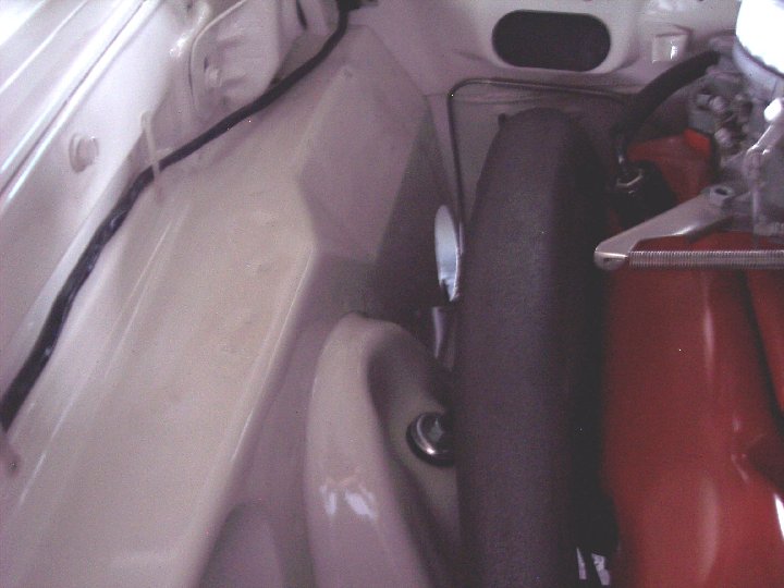

Soooo.... Lets share some max wedge trivia. I would love to have people share knowledge and pictures if possible. I'll share first. There are a lot of max wedge specific holes in the firewall. But what I didn't know is that all 64 (dodges only) have a slanted inner fender on passenger side and a large circular hole below it for tooling. This was supposedly built to accommodate the fenderwell exhaust manifold that never made it into production.

Looks like heaps of room with that bend ..they are angled over in this area...cool item though .Other side is crazy w i d e too.

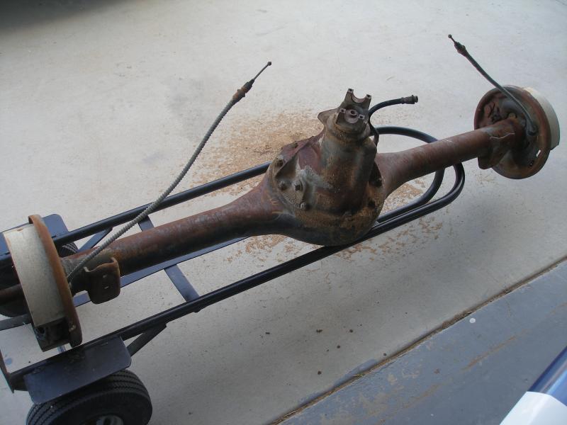

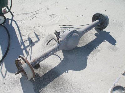

While this is not Max Wedge specific, it might still be of interest for someone. Early 8 3/4 rears were stamped for gear ratio they received from the factory, not like the later ones that had metal tags on them. So 1962-1963 Max Wedge cars should have 3.91 (or 3.91S depending on the source) stamped on them. I believe 4.56 gears became an option from the factory for 1964, so it could also be seen on the "pig".
So a question for everyone who has an original rear end on their MW car ... what is stamped on yours and what case (741, 742, 985) do you have?
Below is a 2.76 stamping from my 1964 Dodge 440 wagon to show where it is located.

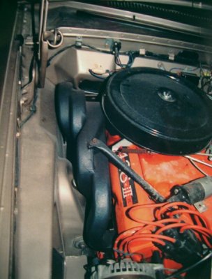

Interestingly enough, this Plymouth seems to have the same "Hole" you mentioned in first post.

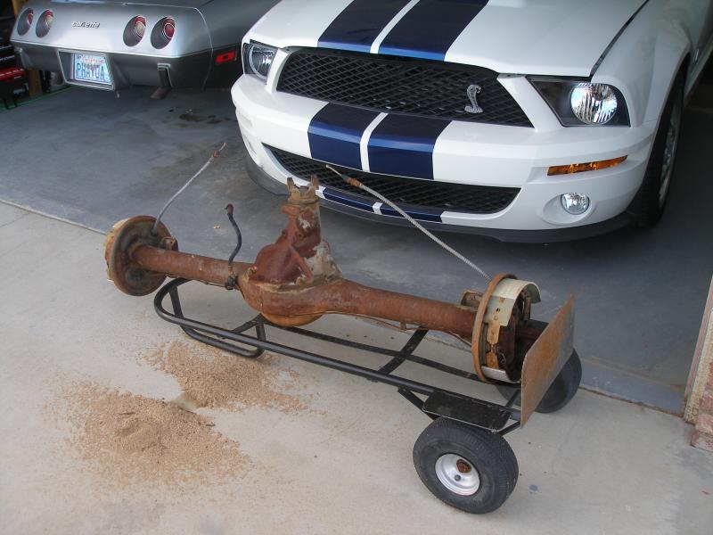

I DO have an original Max Wedge rear-end.
741 CASE
3:91
