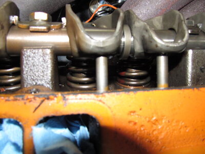

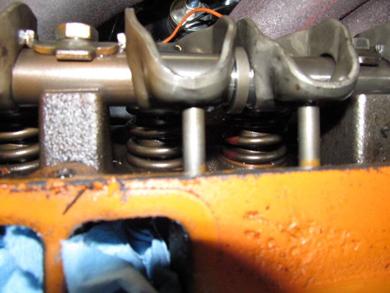

Does anybody know the correct valve stem seals to use on mopar performance 2406518-M reproduction max wedge heads? Original build lists Mahle B45403 and/or 45343 but Mahle stuff does not seem to be around any more? Rock Auto lists FelPro SS12419 for a 426 but they look different.

Pretty sure single springs unless the flat ones inside count? Forgive my ignorance I don't usually work on my own valvetrain stuff. The seals in there now appear to have the spring or springs around their diameter like the mahle ones do
