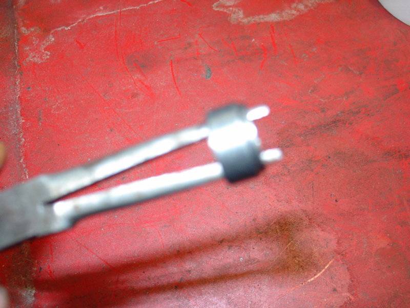

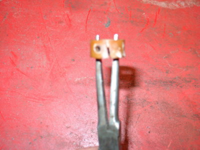

You need to change that plastic bushing on the distributor ASAP, have rebuilt hundreds of them and never saw one like that junk it and get a metal one no 45 year old nylon will not break in half, as shaft play goes I set mine no more than .002 total side to side. Also check your mechanical advance is free easy check hold the shaft in say a vice or the engine and turn the rotor ccw it should move a few degrees then snap back slowly to the starting have to be oiled that is what the felt is for under the rotor.

The nylon spacer looks worse than it is—Looks like somebody put some pliers on it or something at some point. Could be changed, but not urgent—gotta find one anyway.
