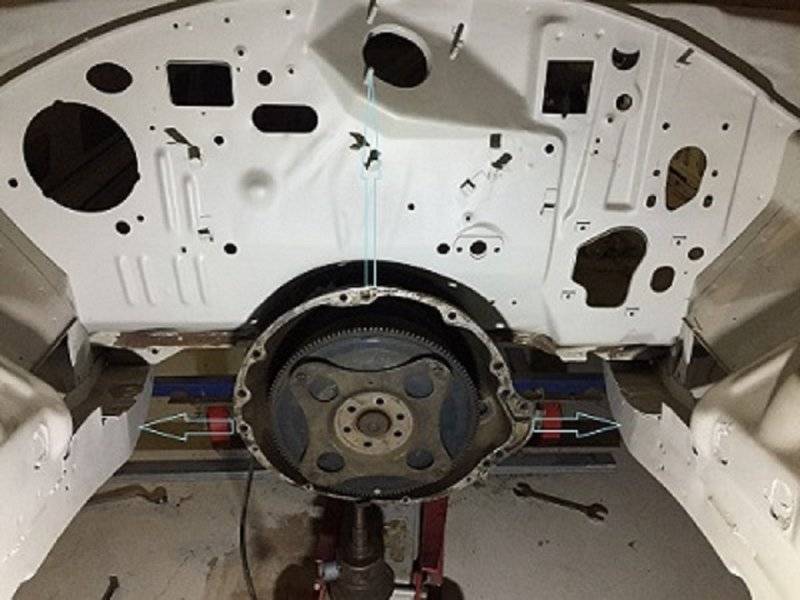

Hello need 3 measurements as in the picture on a 69 charger with 440 727 auto but i think most B Body would be the same .I'm trying to get the gear box in the right position so i can the alignment of the auto floor shifter so i can weld in the shift & console brackets on the new replacement floor

What are you searching for grasshopper? If you are welding anything it be best to wait 'till the engine is in.
If your transmission is in place.
I would try installing linkages and shifter.
Take the console place it over the shifter.
Put the top plate on, move the shifter fore and aft until that is good.
Take the top plate off, and take note where the brackets would align with console braces.
Is there any indication at all on the floor pan, where the brackets should be.
