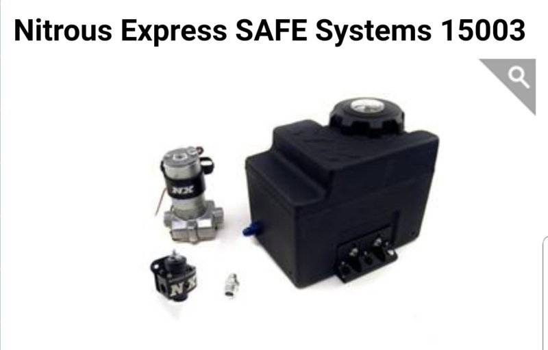

I am likely to use one of these, if I am still running my Holley 3x2 system and have not switched to a 3x2 EFI system.
I'm also thinking that this seperate 1 gallon fuel cell could be filled with race gas or AvGas so you get a boost in octane along with the nitrous.
https://www.summitracing.com/parts/nex-15003/
