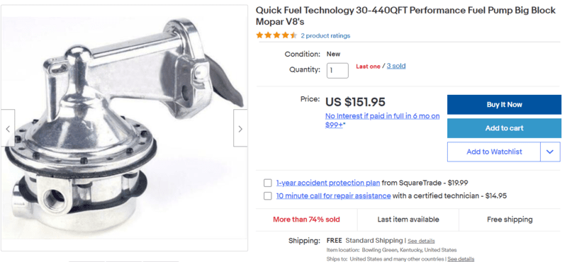

I mean QFT makes a mech pump that runs at 80psi and 110gph
https://www.ebay.com/itm/132985796902?hash=item1ef6923926:g:ksAAAOSwLMFch6NK\
Should be fine for what your doing
