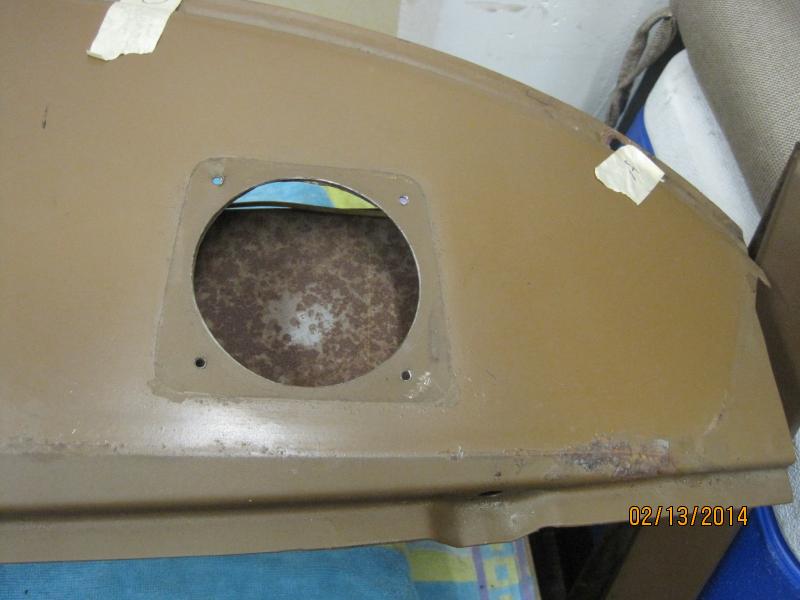

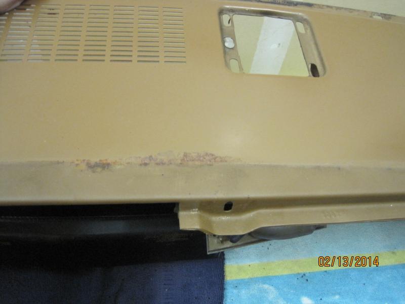

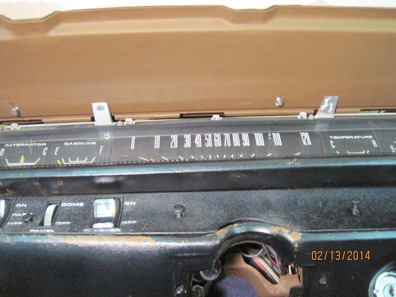

Here's some pics: first the front. Ironically between the woodgrain plastic panels, lower dash pad and gauge cluster, not much of the saddle tan shows up anyway. And the color variation is because of the lighting.

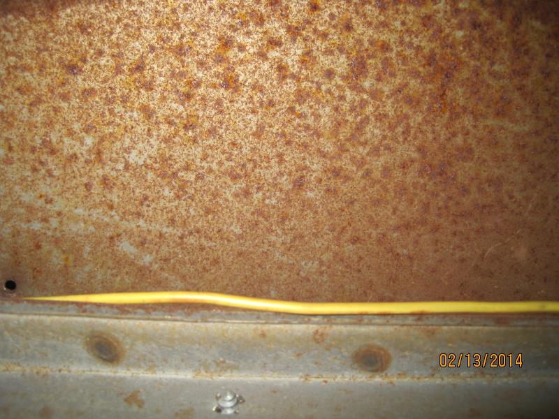

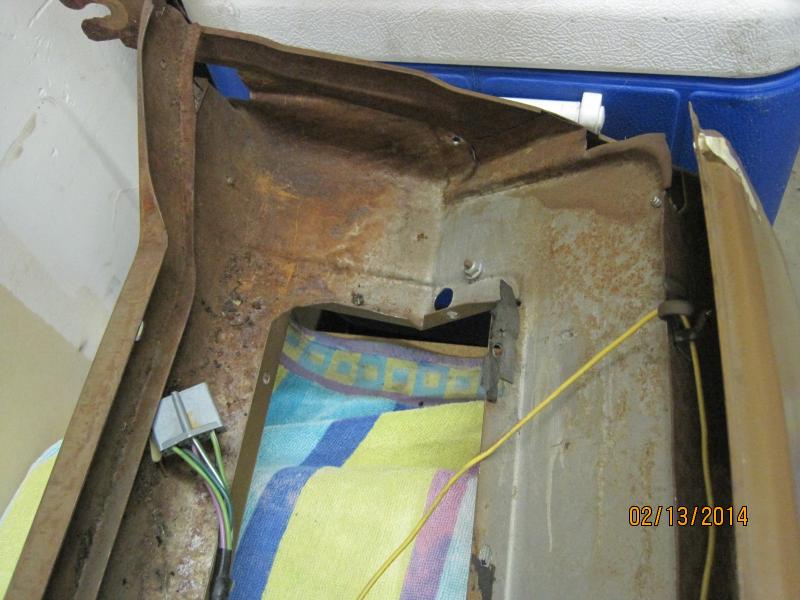

The top has rust along the dash pad rail. Looking down inside the speaker holes you can see all the surface rust.

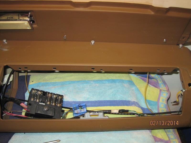

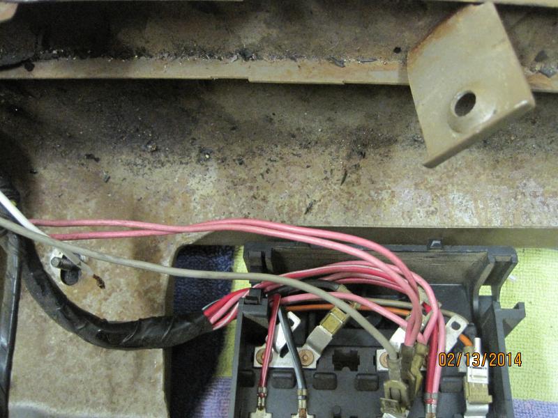

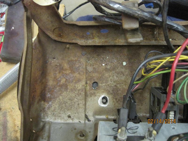

IMG_1300.jpgIMG_1298.jpgIMG_1297.jpgThese pics are behind the glove box, fuse block and gauge cluster. The last pic is a close-up of underside of top of dash.

Thanks Phonton, that's good looking paint.
You know after taking the photos and looking at it again, I'm thinking media blast is the choice. The rust is way up in the back where it would be difficult to hand sand. Alternatively I could POR 15 the unreachable spaces. Maybe I'm tripping out too much on keeping the front intact when 90% is going to be covered by dash pads and plastic trim anyway.
The pics are worth a thousand words. If you are on a budget i would clean up the back (remove loose rust and use a rust encapsulant like POR15). Then sand the rusty part on the front and featheredge it into the good paint. Clean the rest and scuff, primer and hopefully locate some paint close to the original color.

There is enough rust that it would bother me not to redo the whole thing. That stuff Leanna posted looks nice.
If you have the whole dash out of the car it's just not a touch up.
(My opinion )
