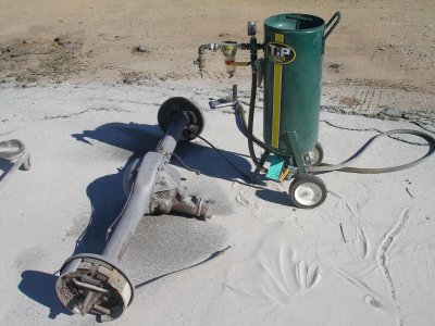

try Brut san co in Canfield Ohio I have a presser blaster form them for the last 25 years. get a carbide tip with it. it has lasted me for @ 16+ years they vary in price depending on size mine holds approx. 80# of media. I use a product called Black diamond or it's called by another name in other part of the country. it's a slag product. it cuts better than sand. at tractor supply it's about $9.00 a bag if you have an area to put a large tarp down and save /recycle the media with a screen for the blaster good luck

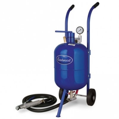

I use Eastwoods media blaster, i only bought the 50 pd capacity one but they have larger, My air compressor is small but if i had one that would keep up with 90 PSI contiuely i swear i would tackle a car on the rotisserie...
http://www.eastwood.com/eastwood-50lb-pressure-abrasive-blaster.html

I have one identical to yours, Ron. Mine came from my warehouse tool supplier. I do use the Black Diamond media from Tractor Supply. I only paid $7.50 a bag for it around here. Works real well. I recently blasted the GTS from the windshield forward so I can restore the engine bay and suspension. I don't recover any material,. I just sweep it downhill, off the driveway.
Those look well built and I like the fact that they sell all the replacement parts. USA made is a plus.
The Eastwood pressure pot blaster is the same as Harbor Freight, but the HF is cheaper!
Yup....I have the same one and the made in China hoses showed signs of rot in less than 2 years and yes, it stays inside.

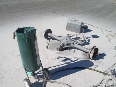

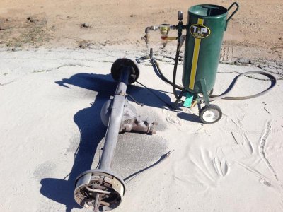

Mine:

That's the exact one I used to have. I couldn't find that company anywhere on the web.

The guy in Tennesse if it's the same one I know in Knoxville, he's good people, and he runs a good operation. The Dustless system indicated above isn't getting clean the areas you really need to get clean; behind the glass and in the channel, and under the qtr panels which gives better access to areas hidden and often rotted. I'm seeing the reality of very little consideration in saving panels that can be replaced; Qtr panels, etc as it's always best to change them out and allow your blaster to get to the inside structure. CFM, you guys are playing in the 'sandbox' (no pun intended) but, I'm running nearly 200CFM. This is why media blasting is not cheap and not for your driveway. If you have not learned this yet, I assure you, you will, but, your wife may learn this before you do! lol! Hoods and some Deck Lids are the holy grail to do right and not mess them up. The most challenging...and I have turned down doing before is the 68/69 RR Hoods, if these have rust and holes, I'll try to get them to pursue a different avenue. I'd rather not take your money for something I know is junk before blasting. The rear differential blasting like that -- a complete assembled unit -- you will get sand or whatever you're using inside the differential. I've deliberately run this test, taken a Corvette rear end complete and blast it, then take it to the Rear end shop for the pre-planned re-gearing it, with them paying close attention to blasting media residue in the differential housing, and, sure enough, it's in there. I never blast any differentials now if they're all together. Bottom line, good luck on your blasting party's!
