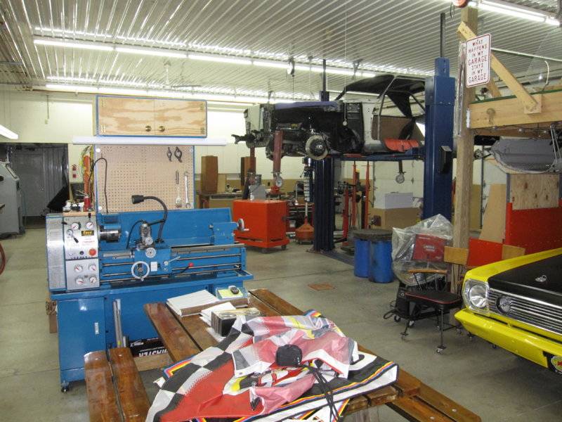

Not a cold environment.. as I have R52 in the ceiling, but you'll love the light reflection and clean look of just using galvanized roofing for a ceiling..

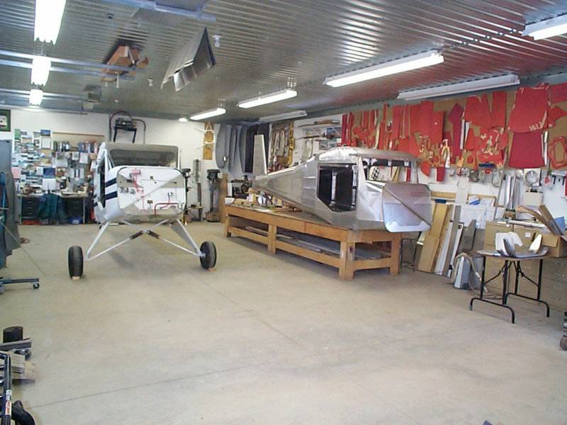

We have steel ceiling and tube heat, Spray foam insulation, dry ceiling all winter here in Iowa.
