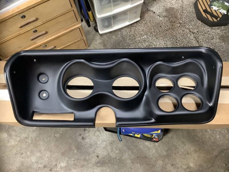

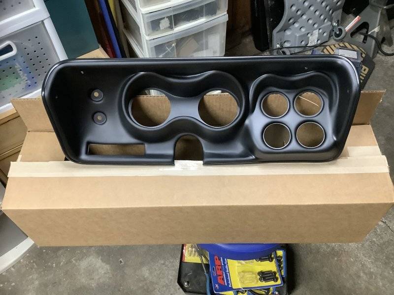

I watched the video numerous times and it seems relatively simple. There is also another setting to stabilize the 5 volt reference but for me that really messed up the range of needle adjustments, plus my factory gauge seems to be dead even though the 5 volt pulse feeds through it. The meter match does work and does everything it is supposed to . I am going to start installing my Autometer dash today and that is going to clean up a lot of crap and get rid of the 5 volt reference and the amp meter as well.

You are right about the new senders being linear and the meter match has limited options to get around this and convert the signal accurately. I totally understand about not wanting to hang an aftermarket fuel gauge on the dash. I planned on converting the dash a while back and was delayed by the pandemic supply issues. I was just hap having a working gauge….lol.
