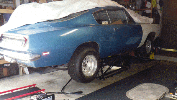

https://www.quickjack.com/

I bought the 5K quick jack and it has become a boat Anker. If you don't have an off site place to store it, it will be in the way all of the time. The hydraulic lines are HARD plastic and can not be rolled up and stored.
For an occasional use it is NOT worth it. You can put jack stands all the way around in the time it takes to set this thing up.
It will not work on my modern stuff. I tried to use it on my Mazda PU and there was no place to put it that would not pinch or brake something. One of the couplings will not come off so I have it in my one bay with the hydraulic hose still attached.
I would not recommend it, but I'm sure there are guys out there that use it on a regular basis and sware by it, I usually sware AT it. POS.
a quick jack?, you will not. There would be no way to get your car onto it.
It will not support the weight of a car driving over it.

Notice on Daves69 how stiff the hose is in the picture he posted. All coiled up and hard to work with.

From powermyster.......... "how do you find the quick jack, worth the investment??"
It serves the purpose I wanted. I have ample room to R&R the trans in my A-body. It's stable while used as intended. It leans up against the wall when stored (with the hoses coiled by the way).
And if I want or need to, I can load the whole thing in the pickup and take it anywhere.
From FU64RY in two separate posts.........."The hydraulic lines are HARD plastic and can not be rolled up and stored."
.........."Notice on Daves69 how stiff the hose is in the picture he posted. All coiled up and hard to work with."
Kind of contradicting yourself here, IMO.
Yes they do coil and yes they can be stored.
As with any lift, there is a learning curve one needs to be successful. That picture depicts the first time I ever used it.
I ment all twisted up. The ones that came with mine are hard and very stiff, they would never store or twist. I called the company and they agreed and said that I was not the first to mention it sent me another pair, exactly like the first ones.

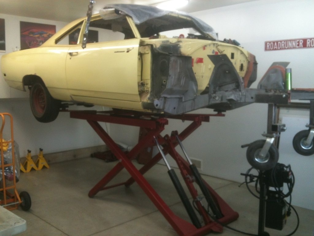

Mine in a shop with 9' ceiling. Easily has 1' to spare at full height This is a full height lift.
