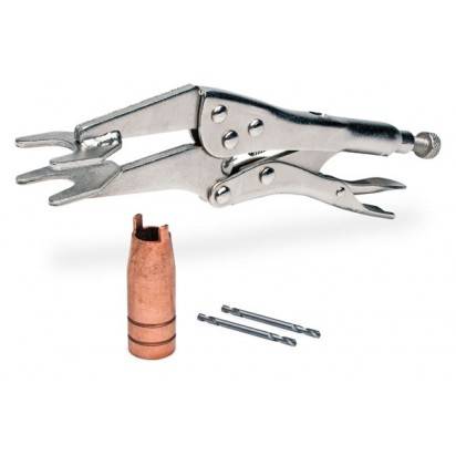

Eastwood MIG Spot Weld Kit
Plus I also used a Eastwood spot weld kit that helped a lot
