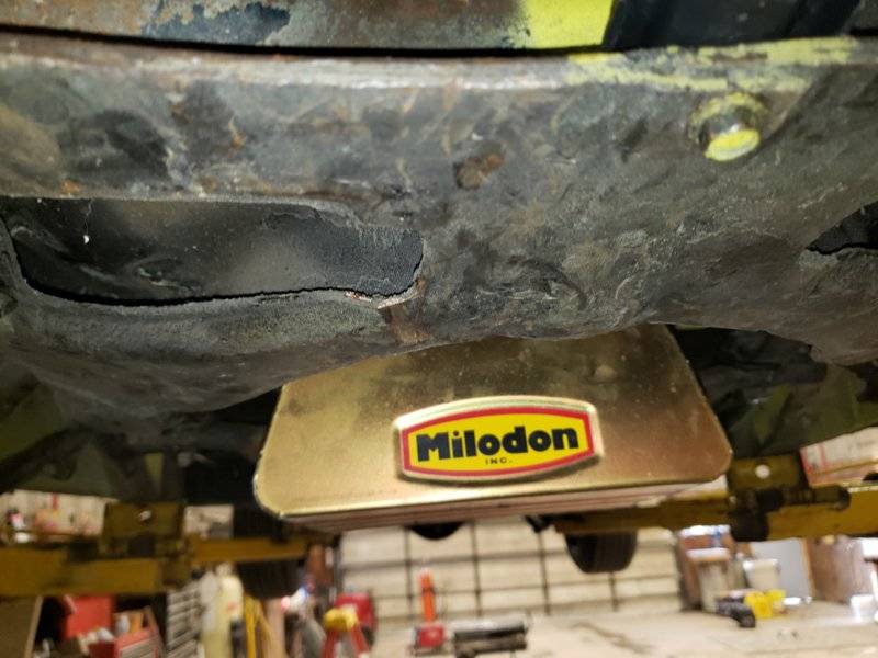

Is it like this one?
This is a 7 qt thats on the 440 in my 70 Coronet.
Clears the K member just fine but Im a bit skittish because it is now the loweat point on the car. A well placed object could take out the oil pan.
