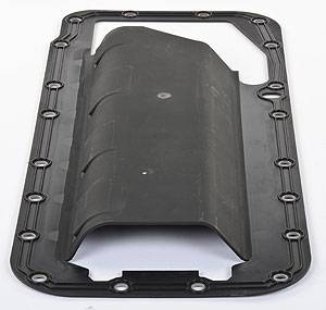

You can use any gasket you want on a Milodon pan. FelPro work great just using some Gaskacinch or coppercoat to hold it in place on the pan. If you're using a windage tray, rather than mess with two gaskets (top & bottom), I recently used a Jeg's windage tray with the built in 'o' ring seals and it works really slick. Composite and reusable. Neat.

I'm thinking about using this gasket myself.
http://www.jegs.com/i/JEGS+Performance+Products/555/502000/10002/-1
but it's expensive at $77 bucks. Anyone want buy some original wind-age trays?
I do, its going to have clearence for a 4.15 stroke crank
Rich
I bought one of those plastic one piece gasket/windage trays from Jegs. The accidently shipped several out that were all for STOCK STROKE. My engine has a 4.15 crank. I was not pleased.
THats a Neat part for sure ! Do thay make it for a stroker RB ?
A 4.15 stroke is the biggest they go for their windage tray.
