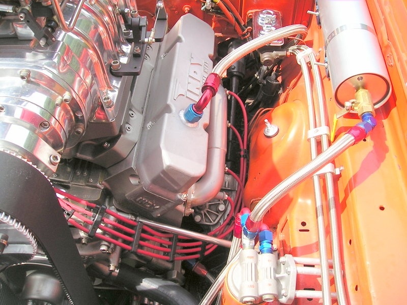

Hi,
I´m looking for this aluminum tube line, that was part of the Milodon Single Line Oil System way back in the days. Also the short rubber hose that connected this tube line to the Pick-up.
Hope you can help me.
Thanks, Stefan

I have a brand new one of those hard lines. I also have a few of the braided ljnes as well - not sure if they're the "short" one unless you can tell me the length you need send me an email at stanton_giles@hotmail.com
Just make one. Piece of tubing,bent,cut and a/n adaptors at each end. short piece of hose. Easier yet is a 180° hose end and braided hose. easily done and easier to route.

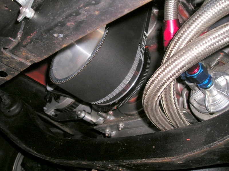

HI STEFAN , IF I MAY ASK WHY DO YOU WANT TO RUN THAT HARD LINE ? I'VE RUN THAT HARD LINE MANY MOONS AGO YOU CAN JUST RUN 1 -12 LINE, ONLY TWO CONNECTION POINTS NOT 4,WITH THE FLARE UNION THAT CONNECTS THE ALUMINUM PIPE TO THE STEEL BRAIDED -12 LINE
IF ONE OF THOSE FITTING CONNECTIONS BECOME LOOSE YOU COULD BE SUCKING IN AIR BUBBLES IN TO THE PUMP AERATING YOUR OIL AND NOT EVEN KNOW IT AIR DON'T SUPPORT THE LOAD OF A CRANKSHAFT. I'M RUNNING A SINGLE LINE SETUP ON MY 493 AND ZERO ISSUES. ONE NOTE GET GOOD QUALITY FITTINGS AND LINE THE FITTINGS THAT MILODON SELLS THESE DAYS ARE CHINESE AND HAVE HERD STORIES THAT THEY ARE PRONE TO FAILURE USE AEROQUIP FITTINGS IF POSSIBLE. GOOD LUCK

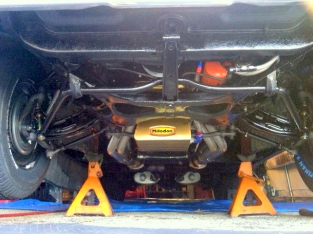

my point is why have 4 connection point when you can have two .less chance for failure. it really not the fittings so much but the way that aluminum line is routed and the flare union connection is in a bad spot up close to the motor mount and block it an old design that has met its time.Milodon did away with that line along time ago.I have run Milodon systems for 30 years on my cars.
Thank you all for your input and good info.
The reason I want the alu tube line and rubber instead of braided lines, is I want my build to be period correct for the SS/B cars. 1968-69 season i.e.
Being an old farmer, I may even have some old fitting to make one. But correct appearance is an importante part of this project, so let see what you have got, Stanton. You got a PM.

Yes MOPAWER871, very nice oil system and engine compartment...
