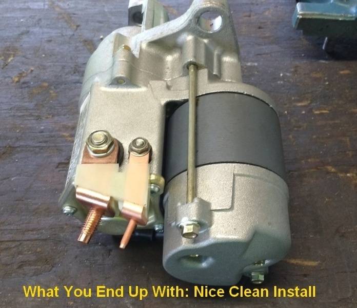

I just bought one of the mini starters for my 72 440 4 spd. I have read older post about these relocation terminals from a member Valiantone but he hasn't been on this site since May of 2018. Does anyone know of another place to find these ?

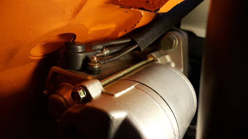

I didn't use one. Either way you should cut off the main terminal almost flush with the nut when the wire ends are installed for block clearance.
I modified the plastic cap to fit just the main terminal.

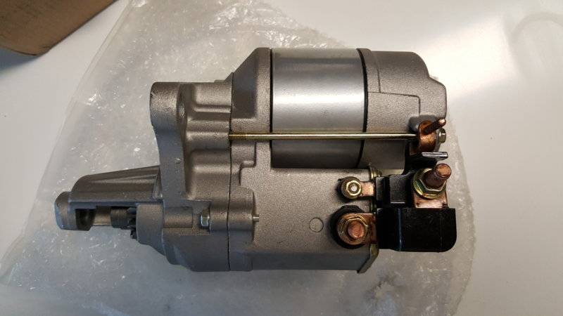

The starter I bought has the terminals on the side towards the block not on top like yours. Thanks O'Reilly auto for the "exact fit" I call that B.S.

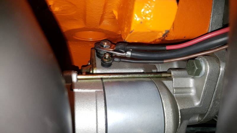

Just take the adapter off. Should work. at least it did on my 440
I took the adapter off on mine - fits the HEMI just fine
I bought this off of ebay. I know it was under $50. Fits 1990's Dodge Dakota, V8.
Here's a pic before I removed the adapter.
