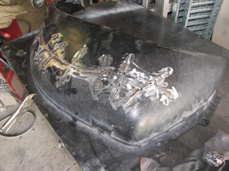

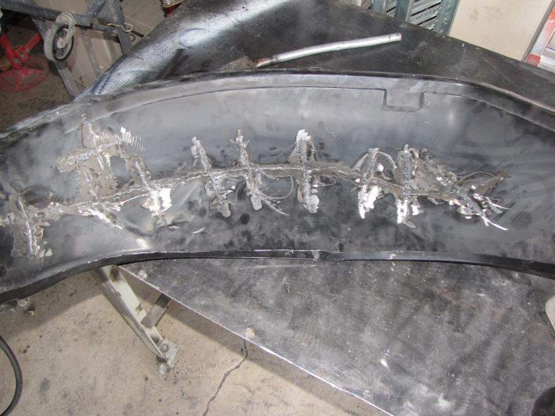

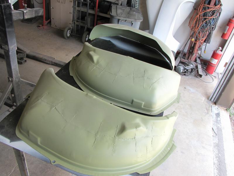

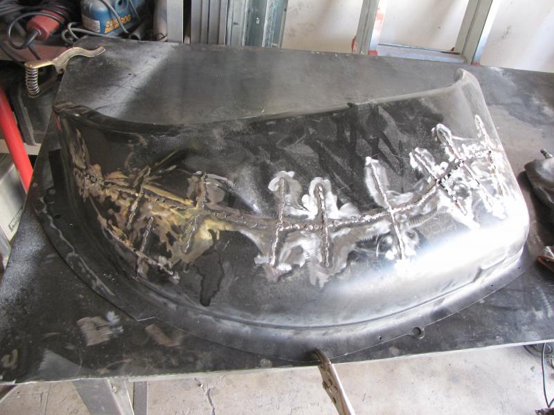

Cut the outer wheel house up and added 2.5" between it and inner tub.
Put the trunk floor piece back in on the other side
Then I'll dive into the outer tub on this side...

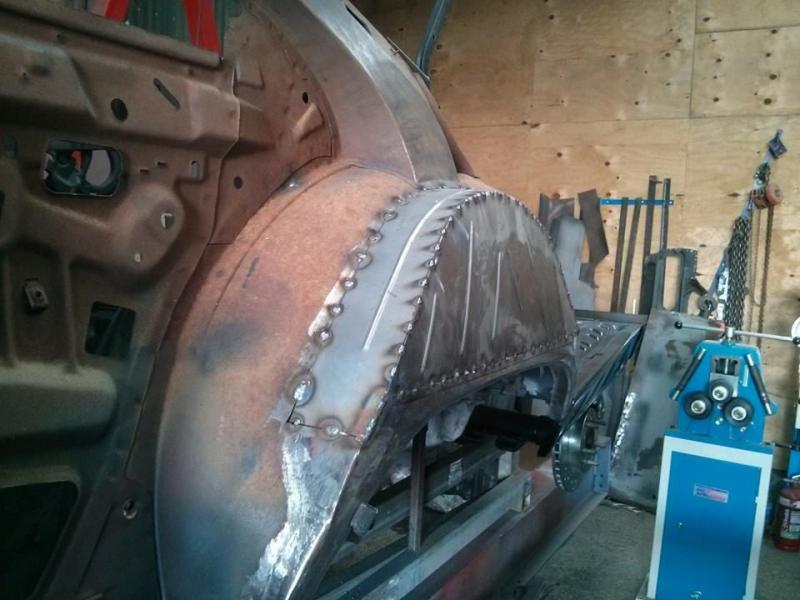

I have the spring relocation on my 70 Roadrunner. I mini-tubbed the inner wheel housings and made a mini tub for the outer housings. I made the wheel tub lip first then welded the 1/2 round face on then fitted sheet metal to meet up with wheel housing. Once it was all welded up I cut out the excess wheel housing from inside the tub. Heaps of room, but I am only using 315's on the rear. Hope it gives you some ideas.1497290_538545506260521_2039457620_n.jpg
Very nice Viper. That was probably a better way of doing it than I did. Way less distortion from cutting and welding I would presume.

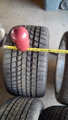

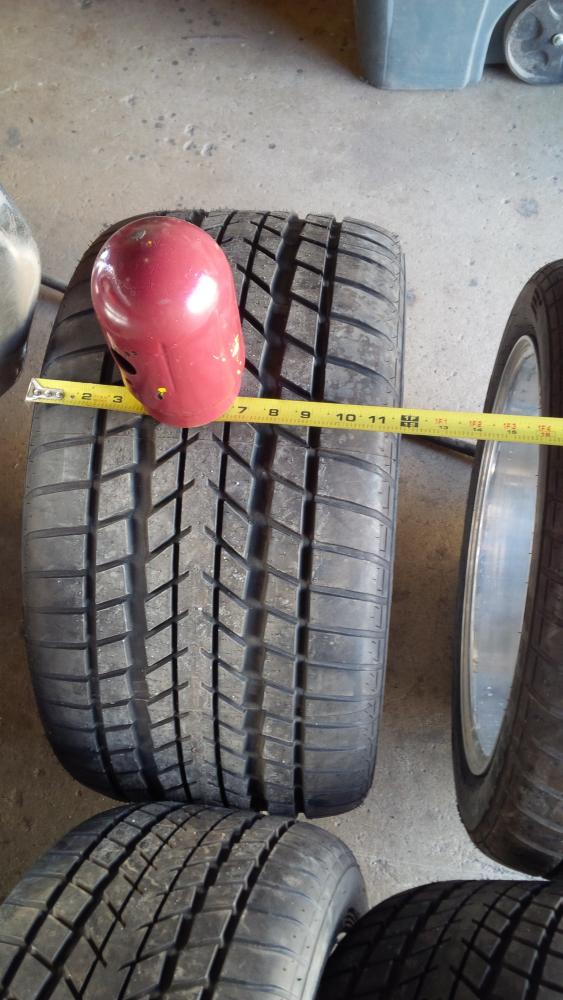

I should be able to put a 14x32 slick in there or whatever size drag radial I decide to run.

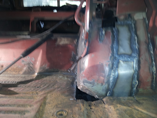

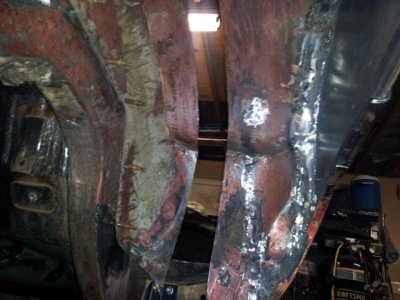

I've got the mini tubs done and it's fully documented in my build thread . . . starts on page 41 . . . I cut the entire outside off and replaced it with a flat sheet of metal, and then filled in the gaps ( from inside the wheel well - that was a LOT of fun ) . . .
Here's the start of the filling - attaching to the flat sheet . . .

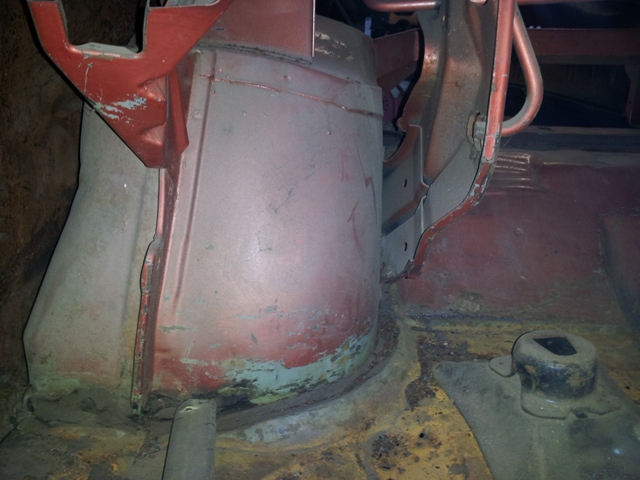

From the trunk - here's the driver side ( originally - didn't get the passenger side before I finished )
And the passenger side after I got it completed . . .

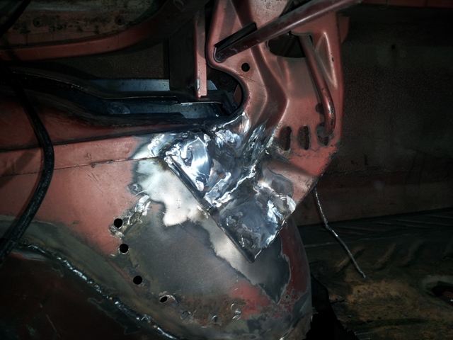

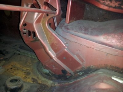

And the trunk torsion bar bracket - how it was originally . . .
And how it was reattached after the inner well was moved into the frame rail . . .

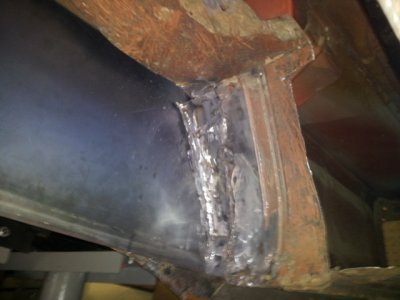

Here the reattaching of the inner well to the frame rail . . . in progress . . .

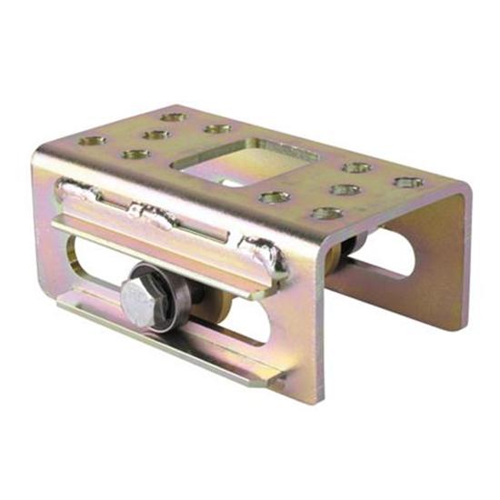

Well, keep in mind I'm building an SFI25.3 racing chassis inside mine, but the front spring boxes will stick up through the floor to raise the front spring eye to lower the car. For the rear, I'll be notching the frame rails and building in rear spring eye mounts that include sliders instead of shackles.
I finished welding out the tub. I still need to grind the welds and go over the seams with seam sealer and paint it all with POR-15 before the quarter goes on.
