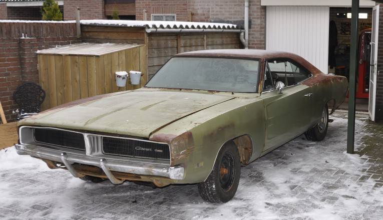

Hello everybody, my name is Marco and I live in the Netherlands. A few years ago I bought a '69 Charger. It needed a complete restoration so I started to tear it down piece by piece. The thing is that it was an honest car, by that I mean it was almost completely original and not welded or repainted, so all the things I want to know about the car I can see for myself. The car was sitting for many years, no doubt about that! The thing is that I didn't found any buildsheet and I also don't have the fendertag! The car came from Alabama, it had a sticker on the backwindow wich says " Auburn University". Maybe someone knows something more about the car or has found the fendertag and/or buildsheet? The VIN is XP29H9B394063, any info or pics are welcome.
Greetings, Marco (www.69charger.nl)

We can tell you A LOT about your car, even if you don't have the fender tag or build sheet. Since you are in the Netherlands, parts are not easy to find, so it is probably 99% the same as when it left the USA. Can you please take a lot more pictures & post them here?

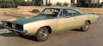

It's the same color (F3 - Light Green Metallic) as the Charger I bought new in Alabama in 1969 (and still own)
. I've only seen one other '69 the same color and without a vinyl top in the 53 years since.
