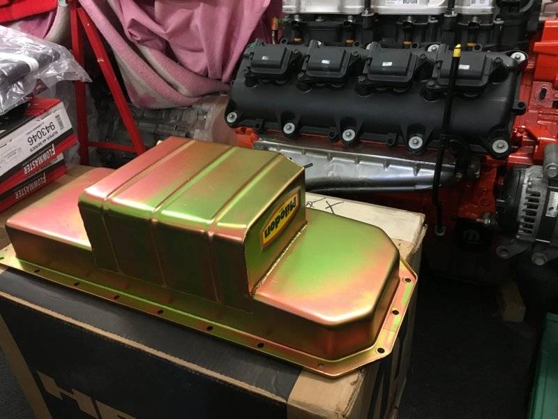

I bought a new Milodon midsump oilpan for my gen 3 HEMI to fit in my 68 Charger. Upon closer inspection I noticed that the new oilpan does not have any provision for fitting an oilstick?
Anybody else with this issue?
Would very much like to be able to check the Oil level from time to time

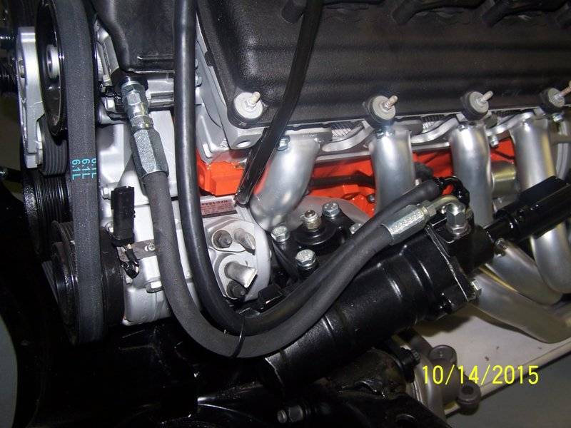

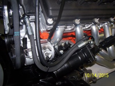

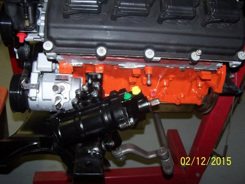

On the drivers side, you will find a plug in the block just above the oil pan. You will need to add a tube and dip stick there. I got mine from Bouchillon Performance but you could use an aftermarket flexible tube there also. Here is a pic of mine
